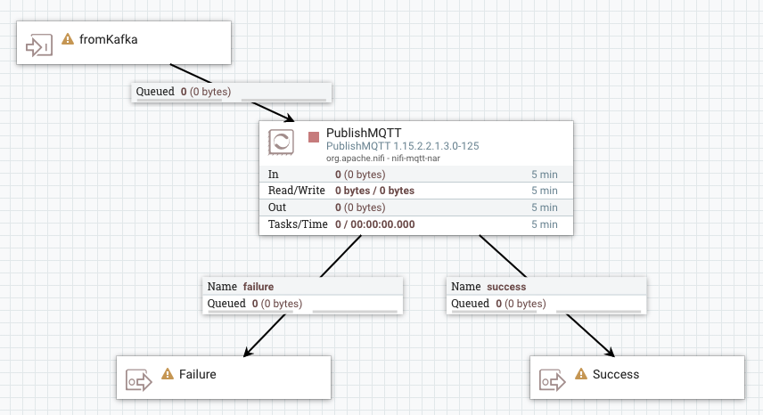

    Alternatively, you can also build a dataflow to deploy as a sink connector. The following is an example dataflow for a simple MQTT sink connector. It consists of an input port (representing a Kafka topic), a PublishMQTT processor, and two output ports.
    In the case of this example, a failure output port is required. This is done so that in case the destination is not available, the session can be rolled back and the Kafka message can be declined. The failure port is specified in the configuration of the connector when deploying it through Streams Messaging Manager.

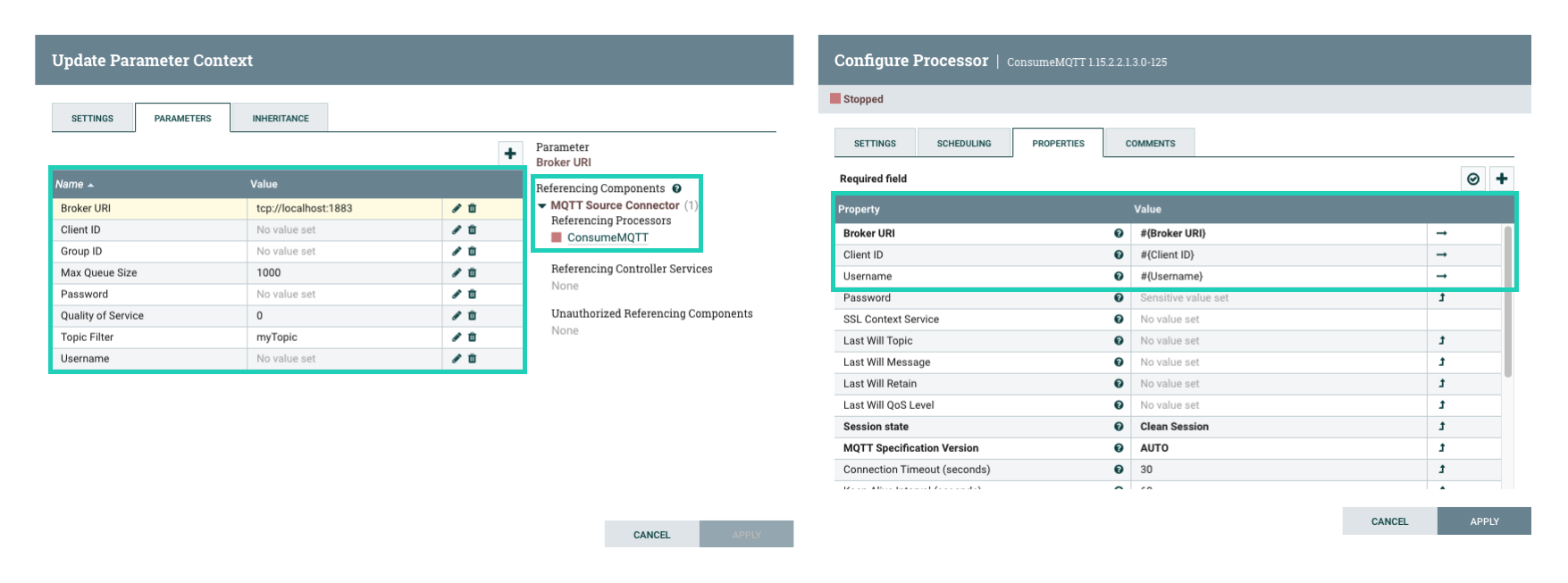

    When designing and building your dataflow, ensure that you update your parameter context and reference the parameters in your components. For example:
    Keep in mind that sensitive properties in processors or controller services must always be parametrized. That is, they must get their values from a parameter in the process group’s parameter context. This is because the values of sensitive properties are not exported with the process group, therefore, they must be configurable when deploying the connector.
    Additionally, sensitive processor or controller service properties can only reference sensitive parameter context parameters. That is, the parameter must be marked as sensitive during creation.
