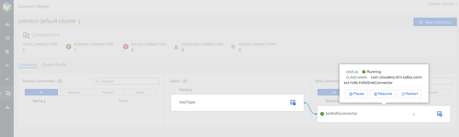

  5. Verify that connector deployment is successful:
    1. In the Streams Messaging Manager UI, click the Connect option in the left-side menu.
    2. Click on either the topic or the connector you created.
      If connector deployment is successful, a flow is displayed between the topic you specified and the connector you created.
