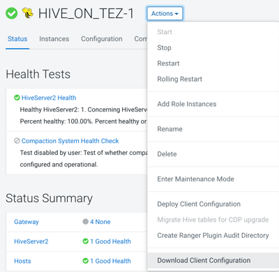

  2. In Cloudera Manager, click Clusters > Hive on Tez to go to the Hive on Tez service page.
  3. From the Hive on Tez service page, click Actions and select Download Client Configuration.
  4. Unpack hive_on_tez-clientconfig.zip, open the beeline-site.xml file, and copy the value of beeline.hs2.jdbc.url.hive_on_tez. This value is the JDBC URL.
