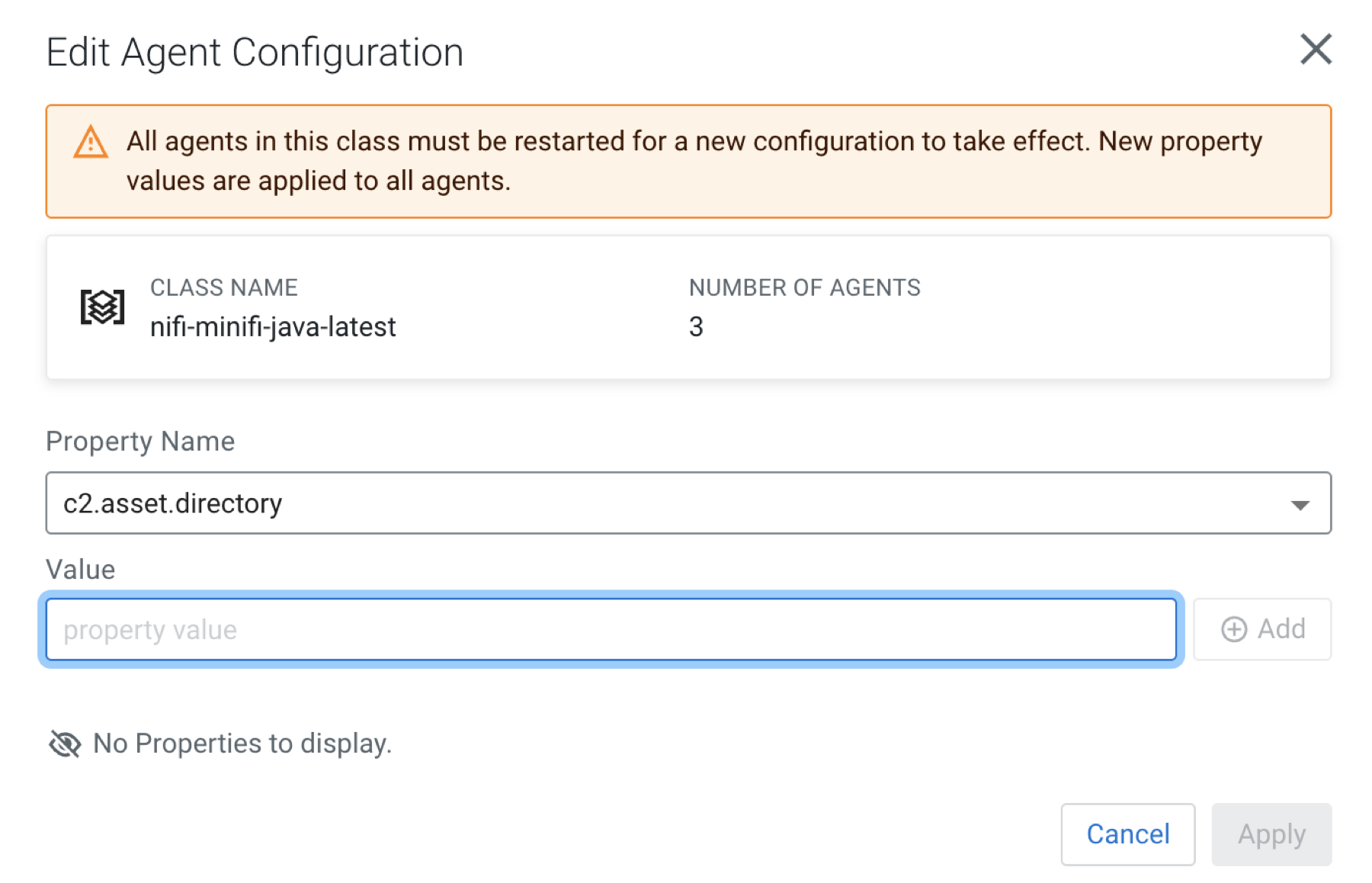

    On the UI:
    1. Click Monitor on the left navigation panel to open the Dashboard.
    2. Select an agent class.
    3. Click Actions > Edit Agent Configuration.
      The Edit Agent Configuration dialog appears:
    4. Select the asset directory property (for a Java agent, it is c2.asset.directory).
    5. Add ./extensions in the Value field, and click Apply.

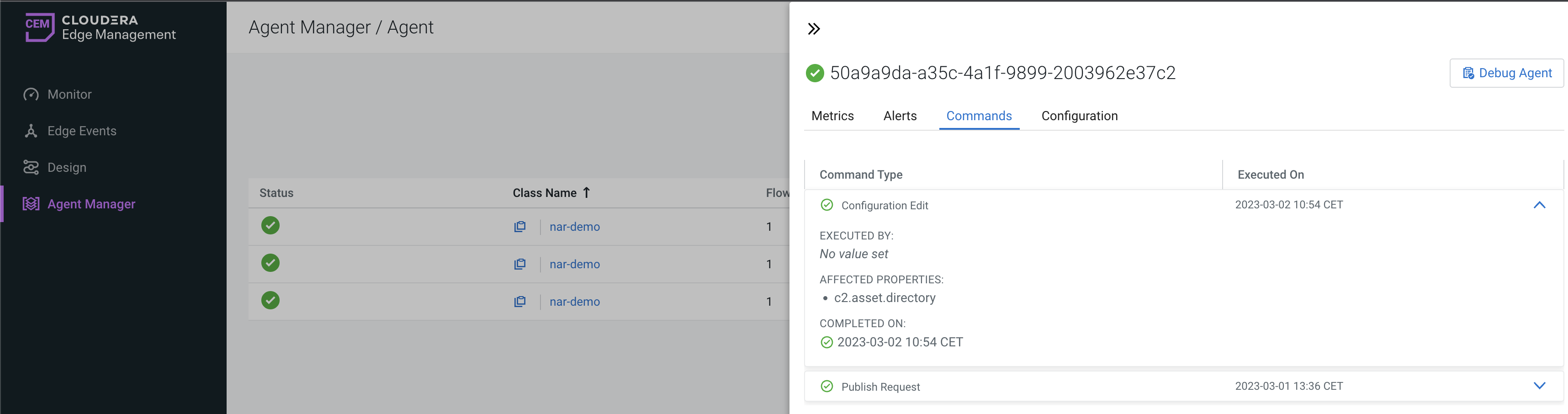

    You can check the command status in the Agent Manager:

    • You can check the command status in the Agent Manager. You have to wait an extra heartbeat interval to complete manifest update.

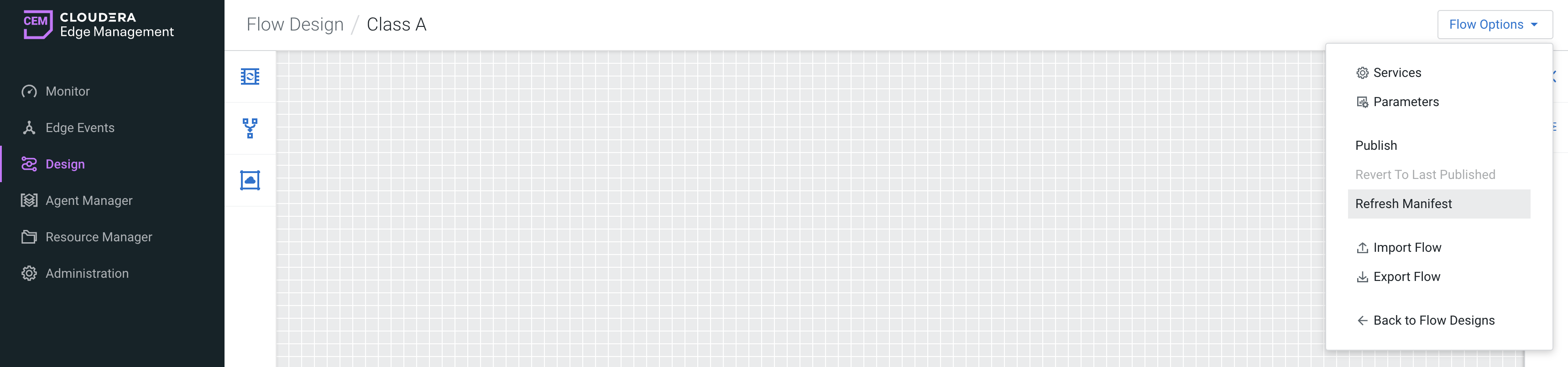

  5. Refresh the agent manifest.
    • For instructions, see Refreshing the agent manifest for existing flows.
    • On the UI:
    • Through Swagger: use
      http://<cem-host>:<cem-port>/efm/swagger/#/Flow%20Designer/refreshFlowManifest
Once the asset push and manifest refresh are complete, the new processors/controller services are available. You can verify the updated capabilities on the Edge Flow Manager UI.
