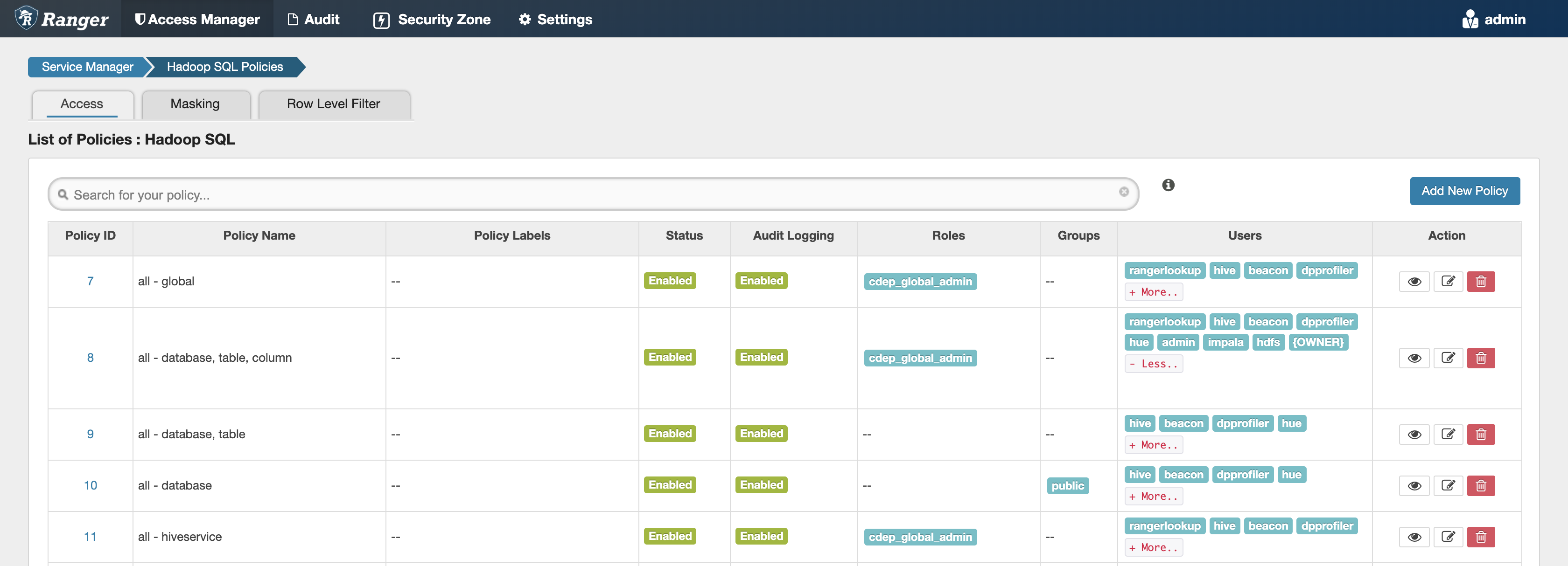

  • The hdfs user must have access to all the Hive datasets, including all the operations. Otherwise, Hive import fails during the replication process. To provide access, perform the following steps:
    1. Log in to Ranger Admin UI.
    2. Go to the Service Manager > Hadoop_SQL Policies > Access tab, and provide hdfs user permission to the all-database, table, column policy name.
    Figure 1. Access tab in the Ranger Admin UI
