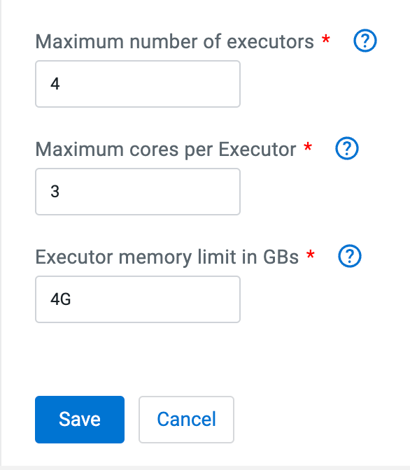

Continue with resource settings:
Set the Maximum number of executors
Indicates the number of processes that are used by the distributed computing framework. The recommended value is at least 10 executors.
Set the Maximum cores per executor
Indicates the maximum number of cores that can be allocated to an executor.
- Set the Executor memory limit in GBs
- Click Save to apply the configuration changes to the selected profiler.

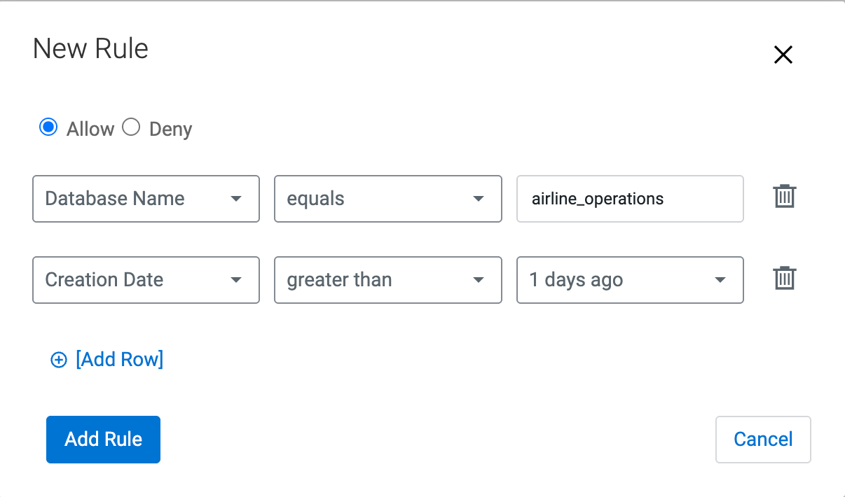

- Click Add New Rule to define new rules.
- Use the radio buttons to define your new rule for the Allow or Deny List.
- Select the key from the drop-down list and the relevant operator. You can select
from the following:
Key Operator Database name - equals
- starts with
- ends with
Name (of asset) - equals
- contains
- starts with
- ends with
Owner (of asset) Creation date1 - greater than
- less than
- Enter the value corresponding to the key. For example, you can enter a string as mentioned in the previous example.
- Click Add Rule. Once a rule is added (enabled by
default), you can toggle the state of the new rule to enable it or disable it as
needed.

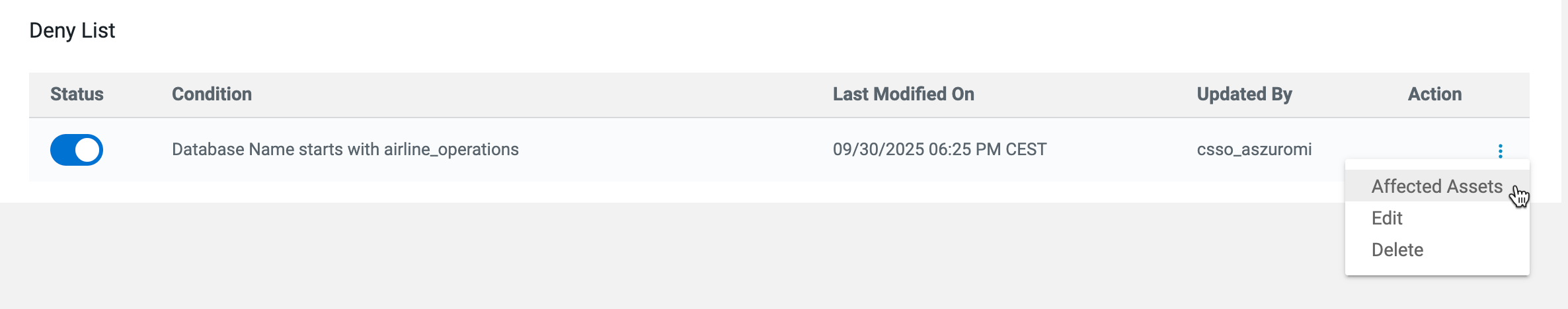

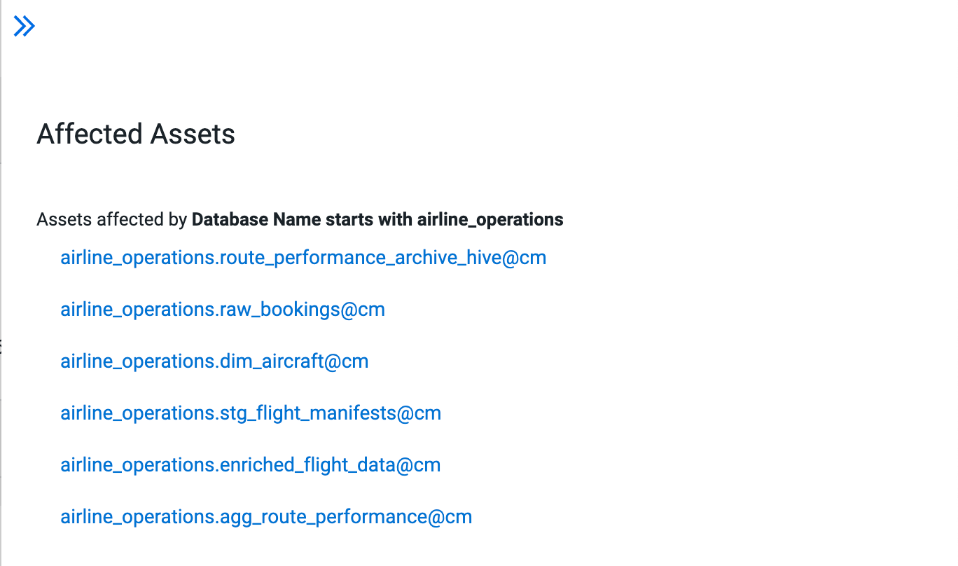

Figure 3. Affected Assets in Asset Filtering Rules configuration

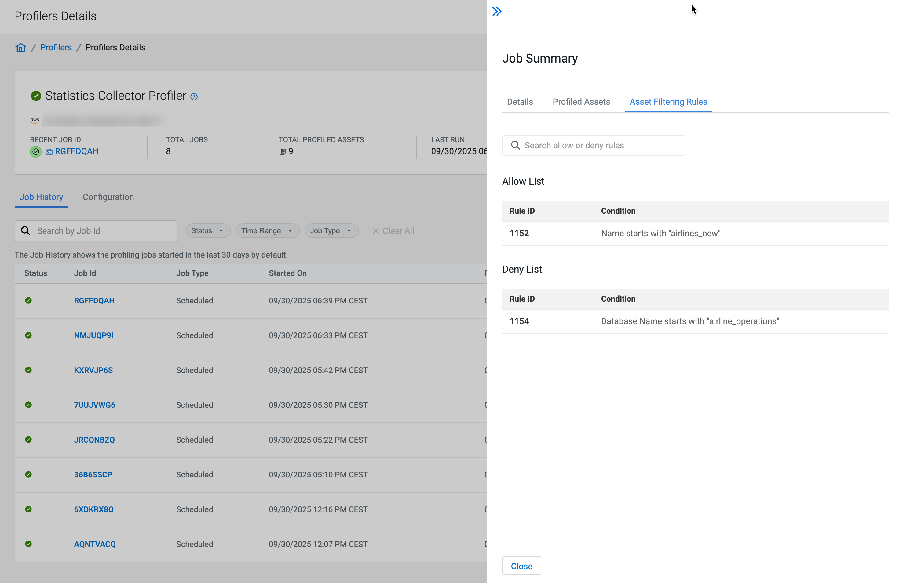

Job Summary shows the asset filtering rules applied for the particular profiling job:
Set your Deny List and Allow-list.
