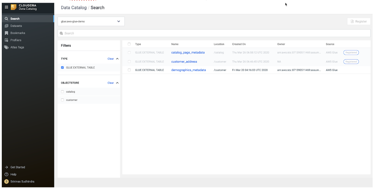

  • List the Glue Metadata by selecting the Glue data lake.
  • Select one or more Glue assets and register the same with Cloudera platform.

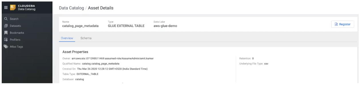

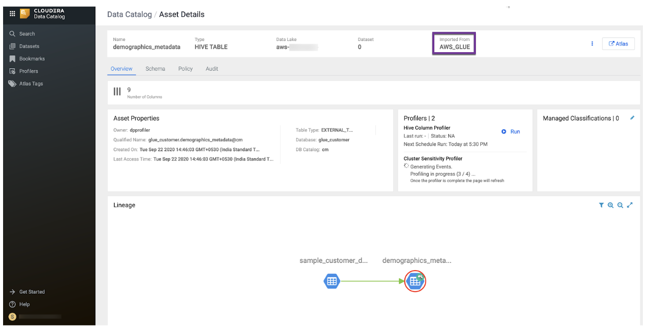

  • Select the registered Glue asset and click to open the Asset Details page.
In Cloudera Data Catalog, when you select the AWS Glue data lake, you can view the list of Glue assets. These metadata assets are directly sourced from Glue.
When you click on one of the assets, the Asset Details page is displayed.

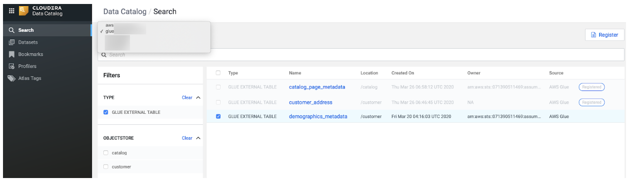

Next, on the main Cloudera Data Catalog page, you must select the Glue data lake and select one of the Glue assets and register the asset to the Cloudera platform. Click Register.
Optionally, you directly click on the Glue asset and register the asset on the Asset Details page.

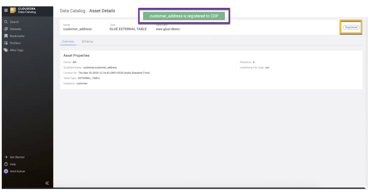

Once the Glue asset is registered, the asset is imported into Cloudera.

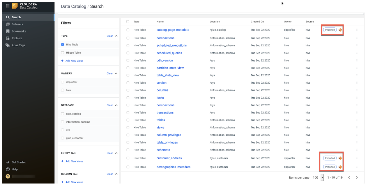

Next, navigate back to the Cloudera Data Catalog main page and select the Cloudera Data Catalog owned data lake and select the type as Hive Table. The search results lists all the Hive table assets and you can view the Glue registered asset(s) as well. The registered Glue asset can be identified using
The Asset Details page for the Glue asset is populated by Atlas. While registering the Glue data, the data was written to the Hive Metastore and later Atlas synchronised the metadata.
Go back to the main Cloudera Data Catalog page and select the Glue data lake. Note that the registered Glue asset(s) are greyed out or cannot be selected again.
You can still view the registered Glue assets (powered by Atlas) by clicking on the same and it navigates to the Asset Details page as seen above in the image.

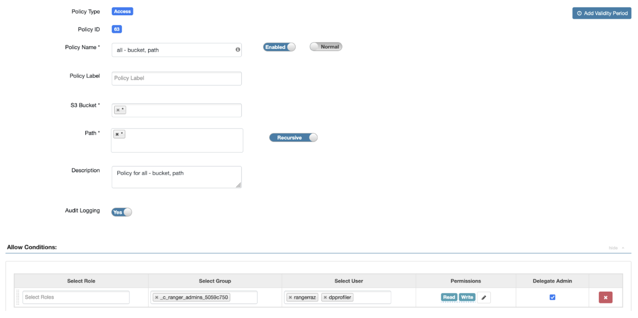

For RAZ enabled AWS environment, you must employ the following permission settings to work with Cloudera Data Catalog - Glue integration.
