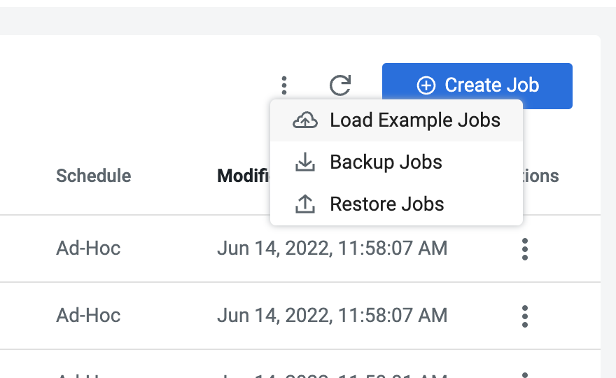

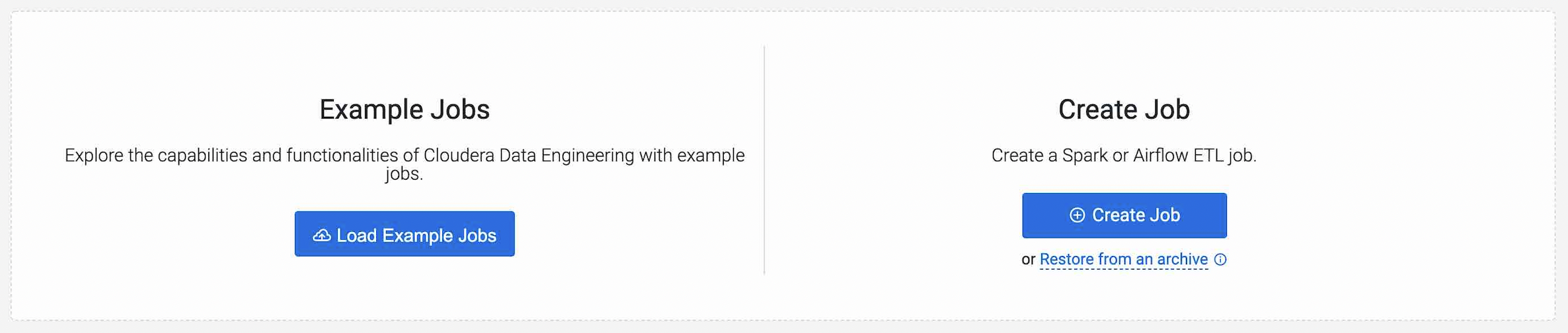

  1. In the Cloudera console, click the Data Engineering tile. The Cloudera Data Engineering Home page displays.
  2. Click Jobs on the left navigation menu.
  3. Select Load Example Jobs from the two options that appear.
  4. If you have existing jobs in the virtual cluster, click on the jobs page to Load Example Jobs.

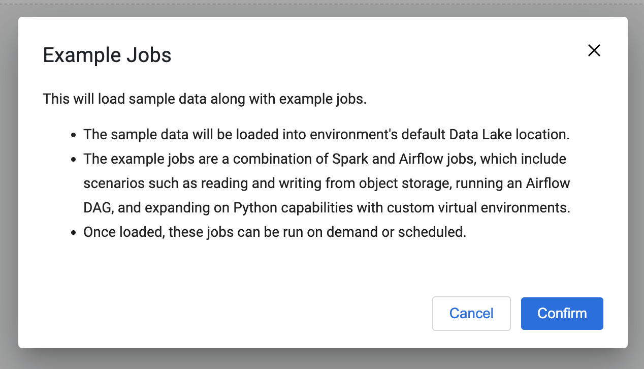

  5. A dialog box appears explaining the example jobs and sample data. Click Confirm to load example jobs and sample data.
Example jobs will be loaded in the virtual cluster and sample data will be loaded in the environment’s Data Lake location.
