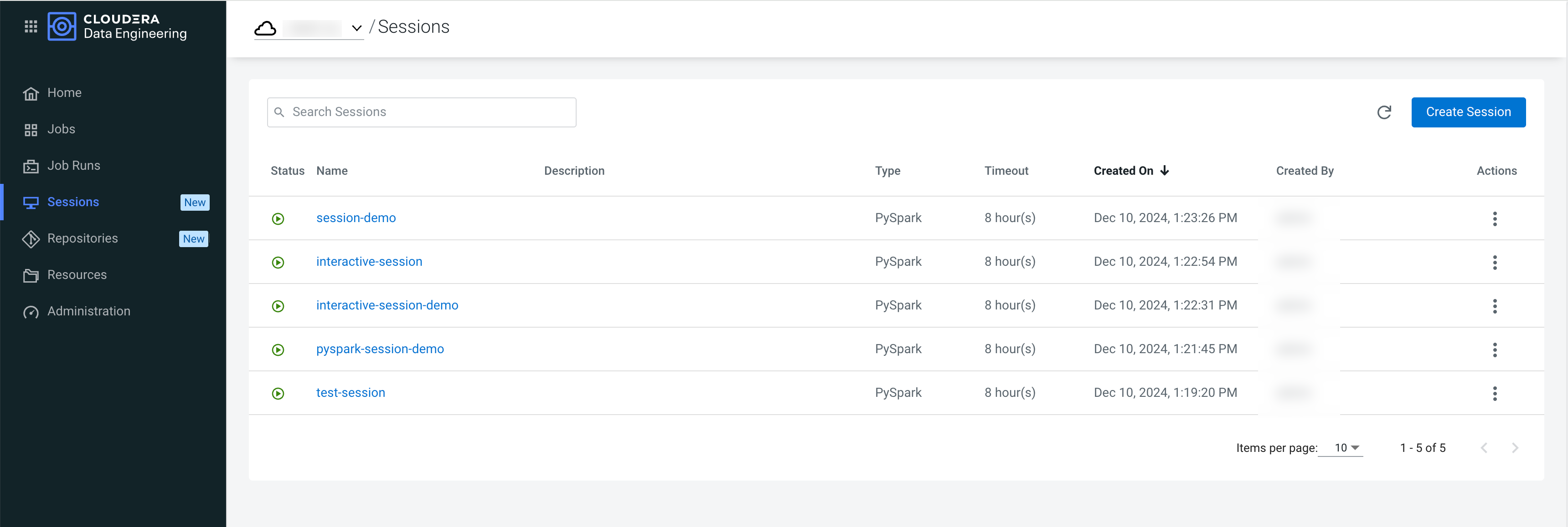

  1. In the Cloudera console, click the Data Engineering tile. The Home page displays.
  2. Click Sessions in the left navigation menu and then click Create Session.
  3. Enter a Name for the Session.

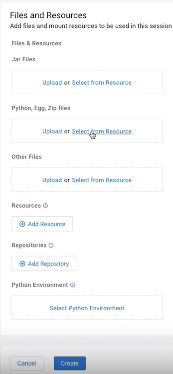

  10. Optional: Under Files and Resources, you can upload Jar, Python, Egg, Zip, and other files. You can also add a resource, respositories, or a Python environment to be used in this session.
    Files that are uploaded to a session are stored in the app/mount directory.
  11. Click Create.
    The Connect tab displays a list of connectivity options available to interact with the Session. The Interact tab allows you to interact with the Session, and becomes available once the Session is running.
