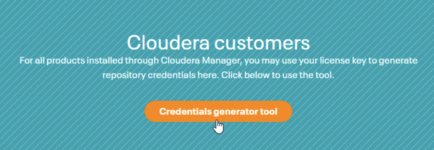

To pull the base Docker image, you must have credentials and authenticate your Docker client to docker.repository.cloudera.com. To get credentials:
  1. Raise an “Admin” type case with Cloudera Support and request a License Key.
  2. Once the License Key is received, navigate to https://www.cloudera.com/downloads.html and log in with your MyCloudera credentials.
  3. Use the Credentials Generator tool - this is about half-way down the page (you will see an orange Sign In button if not already logged in).
    As directed on the page, copy and paste the entire contents of your license file into the text box and click the Get Credentials button to generate your username and password.
