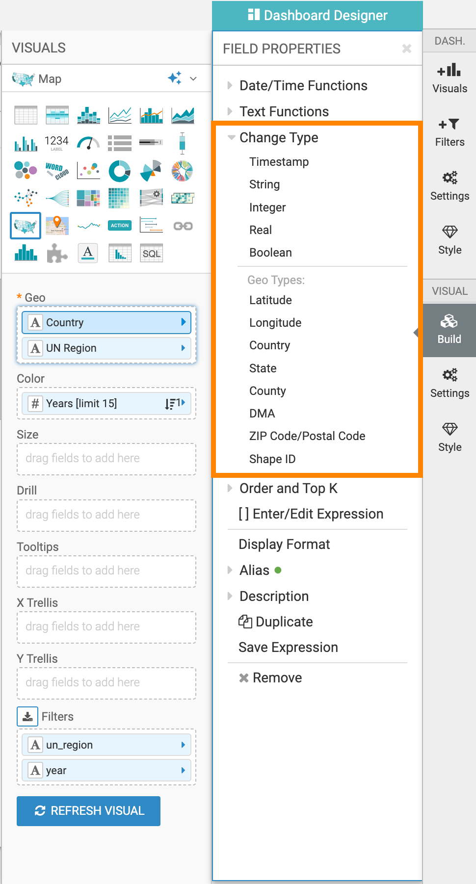

- Click the field you plan to modify, to open the FIELD PROPERTIES menu.
        Under FIELD PROPERTIES, click to expand the Change
            Type menu.
           - From the Change Type menu, select one of the options.

BOOLEAN,cast([field]as BOOLEAN). - Geo Types
Geo Types is a grouping of types that make the field usable on the Geo shelf of Map and Interactive Map visuals.
- Latitude makes the field useable as a latitude measurement
 - Longitude makes the field useable as a longitude measurement
 - Country makes the field useable as a country region
 - State makes the field useable as a state region, for United States of America
 - County makes the field useable as a county region, for United States of America
 - DMA makes the field useable as a Nielsen Designated Market Area Region, for United States of America
 - ZIP Code/Postal Code makes the field useable as a defined zipcode region, for United States of America or postal code for other countries
 - Shape ID makes the field useable as a shape ID

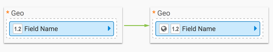

Note that after a field becomes useable for geo visuals, it is marked on the shelf by the (globe) icon.
