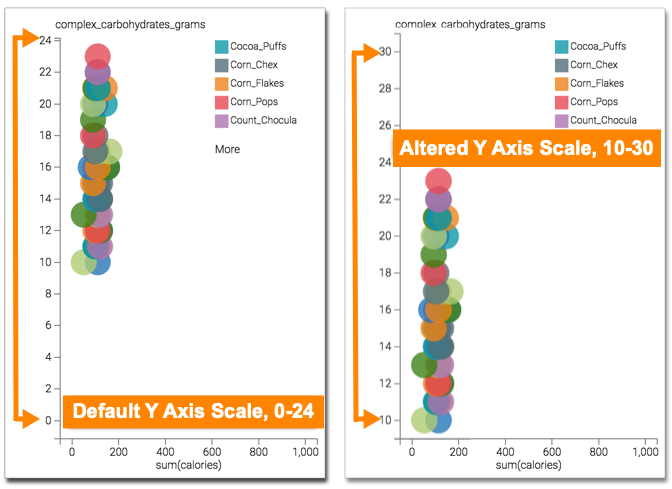

To change the minimum and maximum scale of a continuous Y axis of a Scatter visual, navigate to the Axes menu, and make adjustments to the two selectors, Min Y Scale and Max Y Scale.
The image on the left shows the minimum and maximum scale of the Y axis from 0 to 24. Notice in the right image, how the scale changes when we changed the values from 10 to 30. Increasing the scale gives a clearer visual representation of where the carbohydrate levels fall within a range of values.
Figure 1. Minimum and Maximum Values of Continuous Y axis
