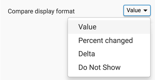

To specify what is reported by the compare indicator, navigate to the Marks menu, and select in Compare display format one of the options:
  • Value (default), that appears on the Compare To shelf
  • Percent changed, difference between the main indicator value and Compare To value, as percentage
  • Delta, the arithmetic difference between the main indicator value and Compare To value
  • Do Not Show, to remove this indicator from the visual

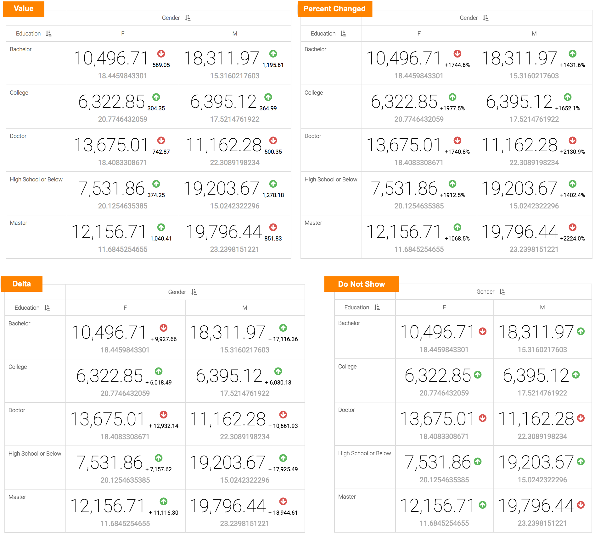

This image illustrates the visual with compare indicator displayed as a Value, Percent Changed, Delta, and Do Not Show.
