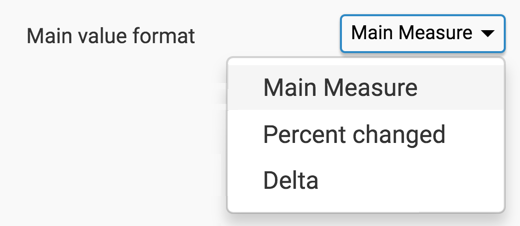

To specify what is reported by the main indicator, navigate to the Marks menu, and select in Main value format one of the options:
- Main Measure (default), that appears on either the Measure or Dimension shelves
- Percent Changed, difference between the Measure and Compare To values as percentage
- Delta, the arithmetic difference between the Measure and Compare To values

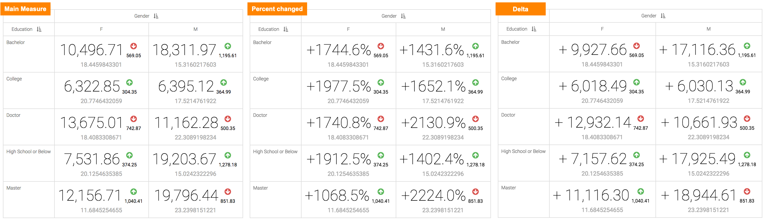

This image illustrates the visual with main indicator displayed as a Main Measure, Percent Changed, and Delta.
