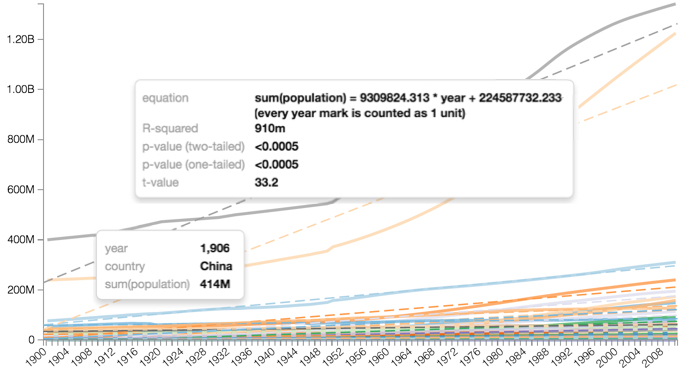

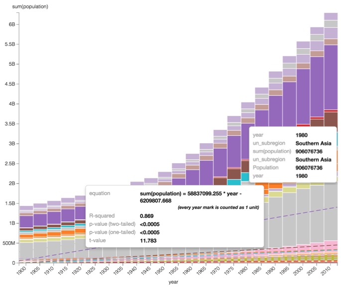

Note that the trendlines appear on the visual. To see the specific values related to the calculation of the trendline, hover your mouse over the trendline and examine the information in the Tooltip window.
Here is a line visual with trendlines. In the following example, notice that a linear trendline clearly shows that population of China has consistently risen over the years.
Here is a bar visual with trendlines. In the following example, notice that a linear trendline clearly shows that the population of Southern Asia has consistently risen over the years.
