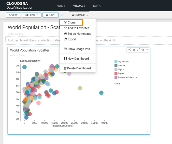

  1. Click Clone to create a new visual that has the same properties as the original.

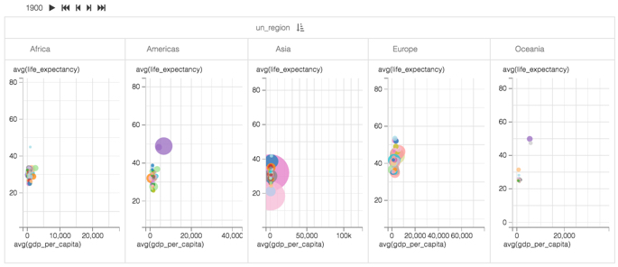

    The Scatter visual refreshes, but this time you can see that it is divided into five separate graphs, that correspond to the identified UN Regions: Africa, America, Asia, Europe, and Oceania. There is a single animation control at the top, so when you click Play, all UN Regions animate simultaneously.
    After running the animation, you will notice that the horizontal axes extend far beyond the necessary space for some of the areas. In particular, the GDP per Capita scale seems too large for Africa.

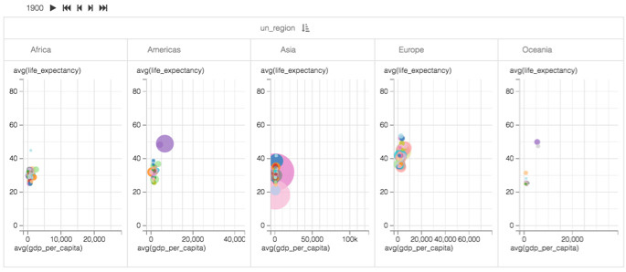

  4. To have each graph use its own optimized scale for the horizontal axis, enable the independent x-axis option, as described in Enabling independent axis scale, and click REFRESH VISUAL.
    You can see that each area has its horizontal scale.
  5. Optional: Similarly, choose the independent Y axis option. The differences in vertical scaling are slight, but still noticeable.
