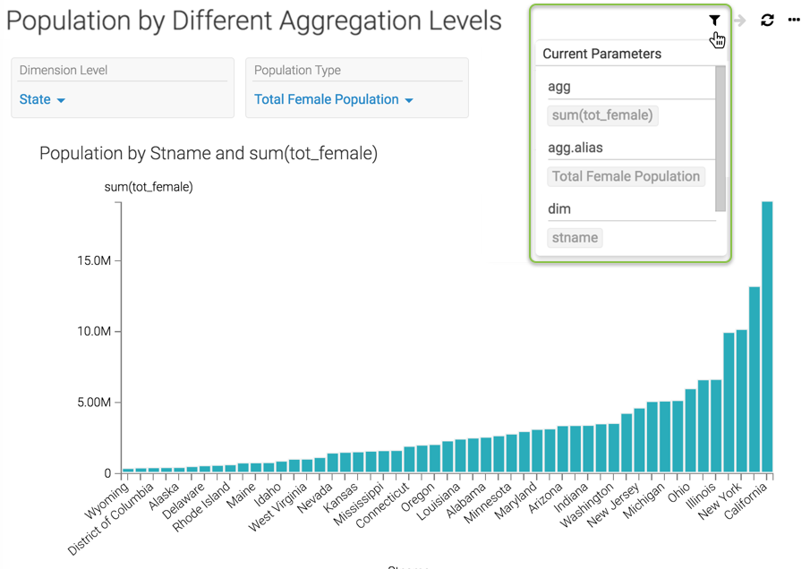

  8. Switch to dashboard View mode.
  9. In the Population Type filter, select Total Female Population.
    Note that the title of the graph and the vertical axis changed to include sum(tot_female).
  10. To check the parameters of the dashboard, hover the pointer over the Filter icon at the top right corner.
    They are agg: sum(tot_female), agg.alias: Total Female Population and dim: Stname. You can scroll down to see the dim.alias: State parameter.
You can now operate the two filters, Dimension Level and Population Type, independently.
You can also navigate between the permutations of filter outputs you create by using filter navigation controls at the top right corner.
