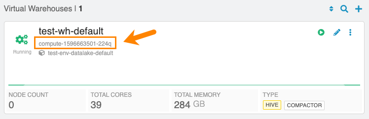

- Get the Cloudera Data Warehouse namespace for your Virtual
Warehouse:
- From the Management Console home page left menu, click Data Warehouse in the left menu. You are taken to the Overview page of Cloudera Data Warehouse on premises service.
- Locate the Virtual Warehouse you want to configure log storage for in the right-most
column of the page, and locate the Cloudera Data Warehouse namespace,
which starts with
compute-as shown below:
