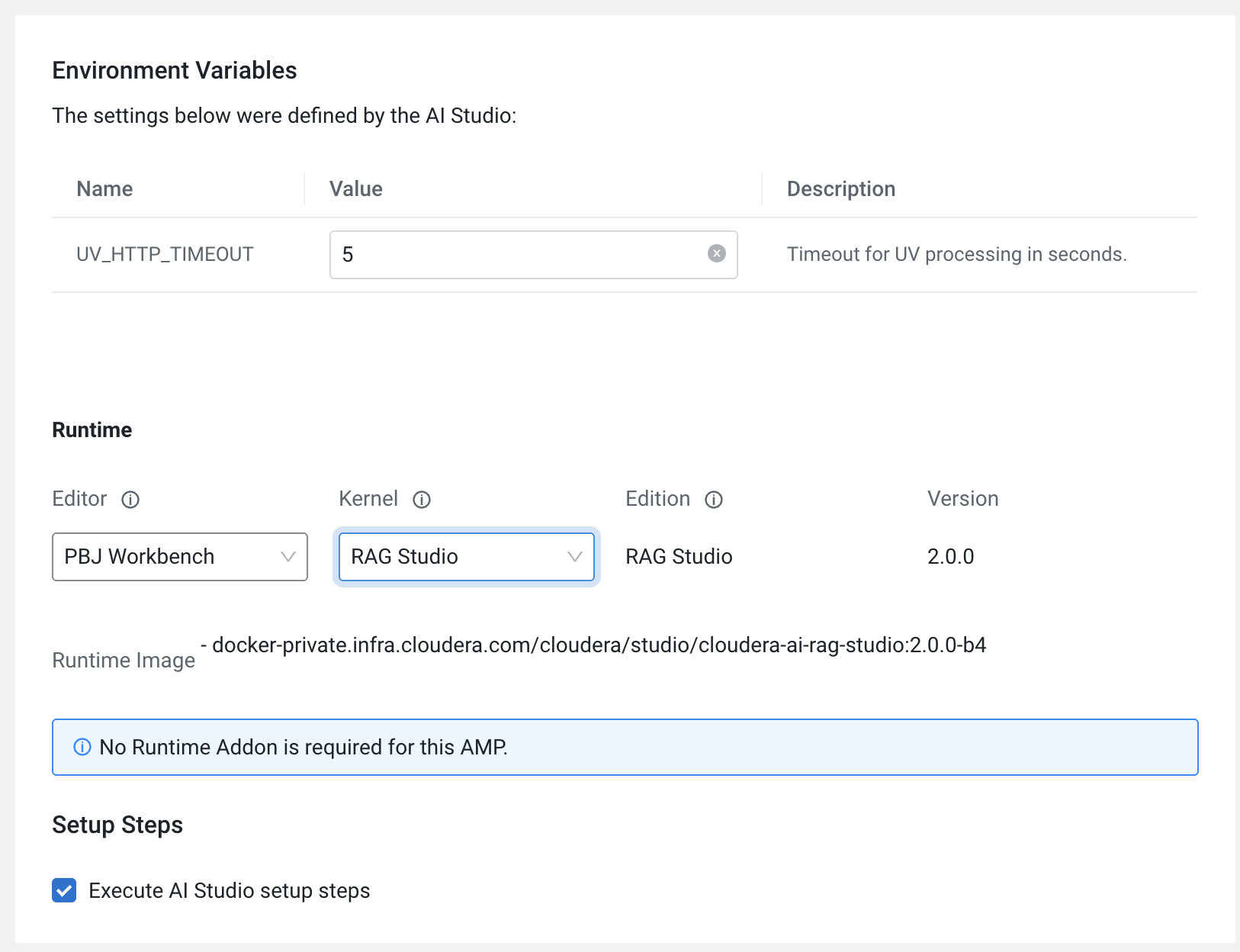

  7. Set the environment variables for the RAG Studio.
  8. Select the Editor as PBJ Workbench.
  9. Under Runtime, select Rag Studio as the Kernel.
  10. Click Launch AI Studio.
