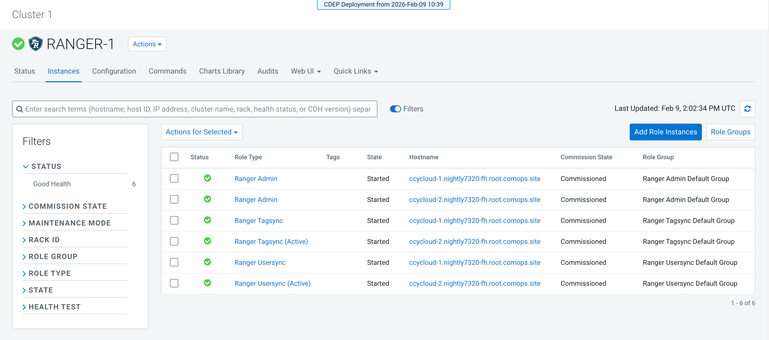

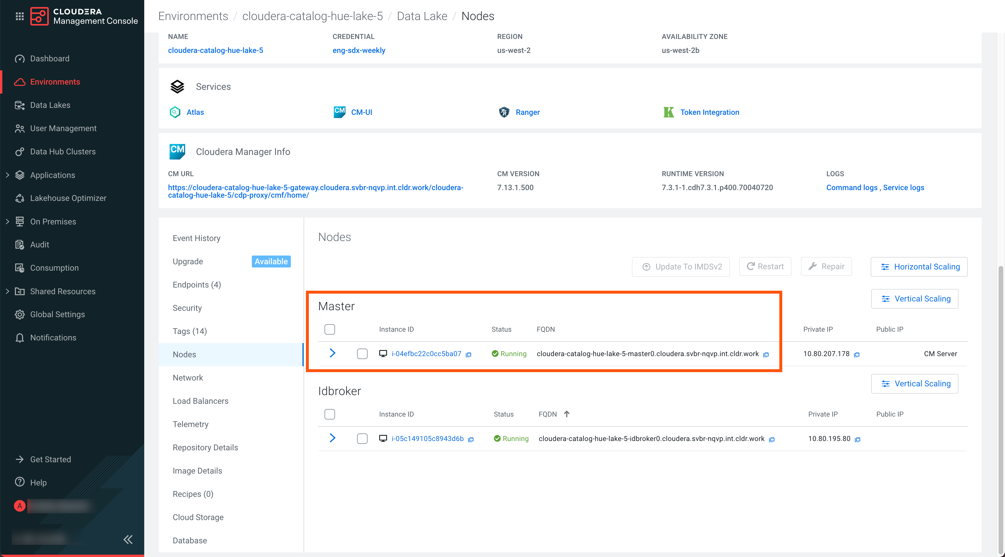

  • Ranger Host: Go to Cloudera Manager > Clusters > RANGER-1 > Instances, and note down each hostname with role type Ranger Admin.

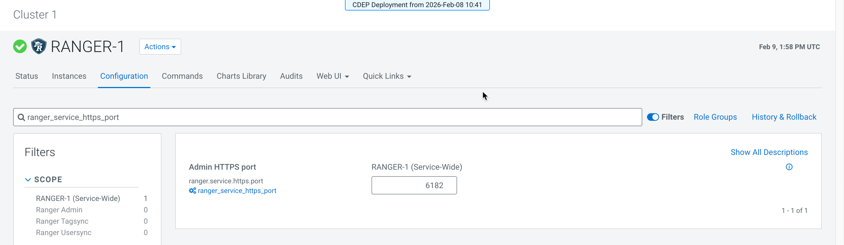

  • Ranger Admin HTTPS port: Go to Cloudera Manager > Configuration, then search for ranger.service.https.port and note down the port number.

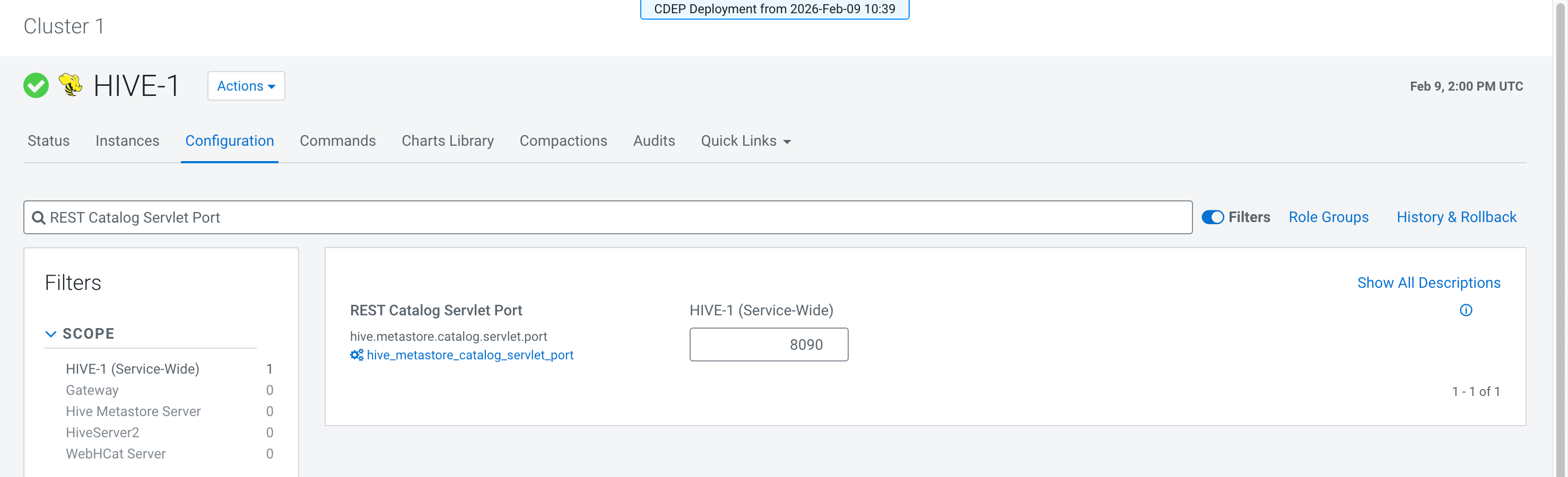

  • HMS Host URL (multiple if high availability is used): Go to Cloudera Manager > Clusters > HIVE-1 > Instances, and note down each hostname with role type Hive Metastore Server.
  • HMS REST Catalog Servlet Port: Go to Cloudera Manager > Configuration, then search for REST Catalog Servlet Port and note down the port number.

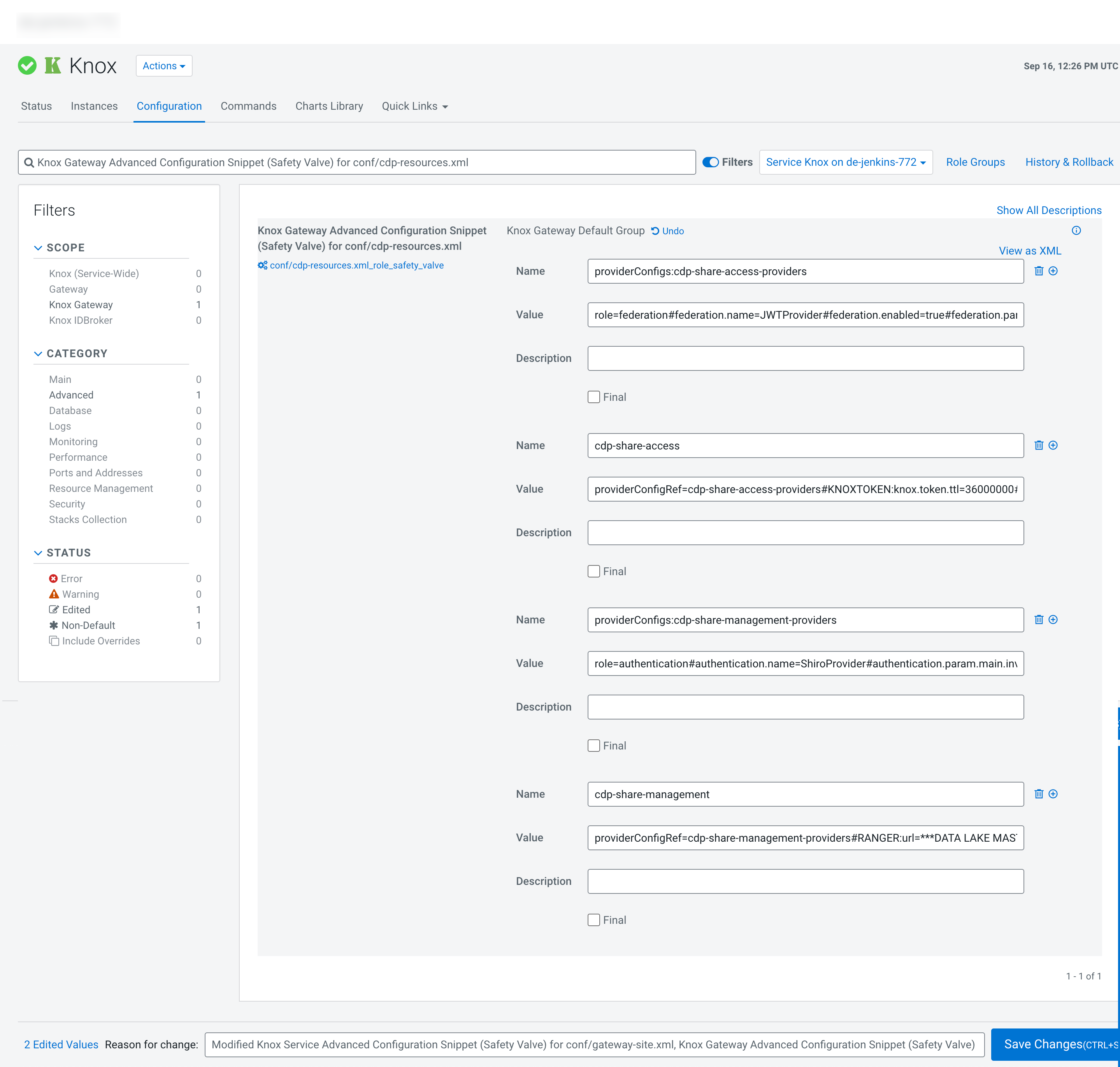

  1. Go to Cloudera Manager > Knox > Configuration.
  2. Select the Knox Gateway scope.
  3. Search for and edit the Knox Gateway Advanced Configuration Snippet (Safety Valve) for conf/cdp-resources.xml property, and add the following after clicking View as XML:
    <property>
        <name>providerConfigs:cdp-share-access-providers</name>
        <value>role=federation#federation.name=JWTProvider#federation.enabled=true#federation.param.knox.token.exp.server-managed=true#role=identity-assertion#identity-assertion.name=Default#identity-assertion.enabled=true#identity-assertion.param.group.mapping.$PRIMARY_GROUP=(not(member username))#role=ha#ha.name=HaProvider#ha.param.HMS-API=enabled=true;maxFailoverAttempts=3;failoverSleep=1000#identity-assertion.param.hadoop.proxyuser.<varname>[***USERNAME***]</varname>.users=#identity-assertion.param.hadoop.proxyuser.<varname>[***USERNAME***]</varname>.groups=#identity-assertion.param.hadoop.proxyuser.<varname>[***USERNAME***]</varname>.hosts=*</value>
    </property>

    Figure 1. Knox topology parameters in the configuration editor after pasting as XML
    #identity-assertion.param.hadoop.proxyuser.[***USERNAME***].users=*#
    identity-assertion.param.hadoop.proxyuser.[***USERNAME***].groups=*#
    identity-assertion.param.hadoop.proxyuser.[***USERNAME***].hosts=*
    The relevant Knox topologies are created.
  4. Click Save Changes and refresh the configuration as needed.
