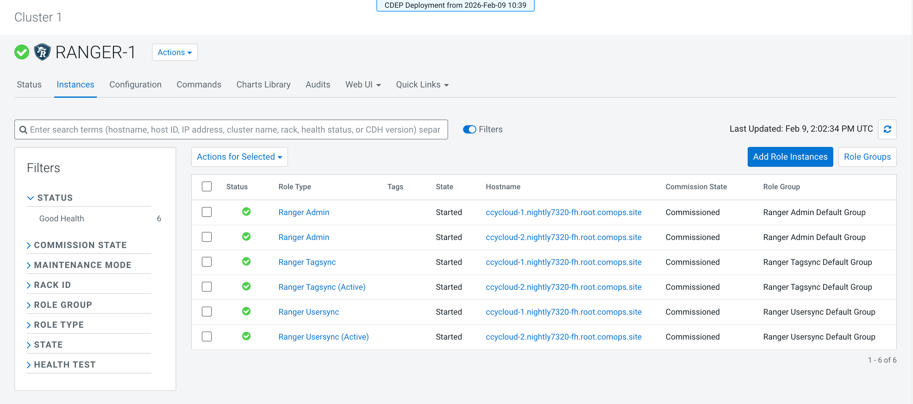

  • Ranger Host: Go to Cloudera Manager > Clusters > RANGER-1 > Instances, and note down each hostname with role type Ranger Admin.

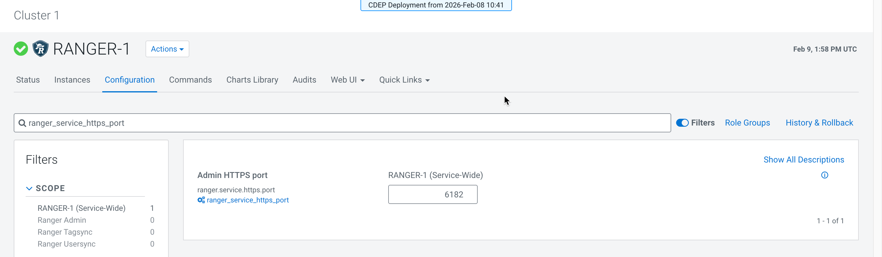

  • Ranger Admin HTTPS port: Go to Cloudera Manager > Configuration, then search for ranger.service.https.port and note down the port number.

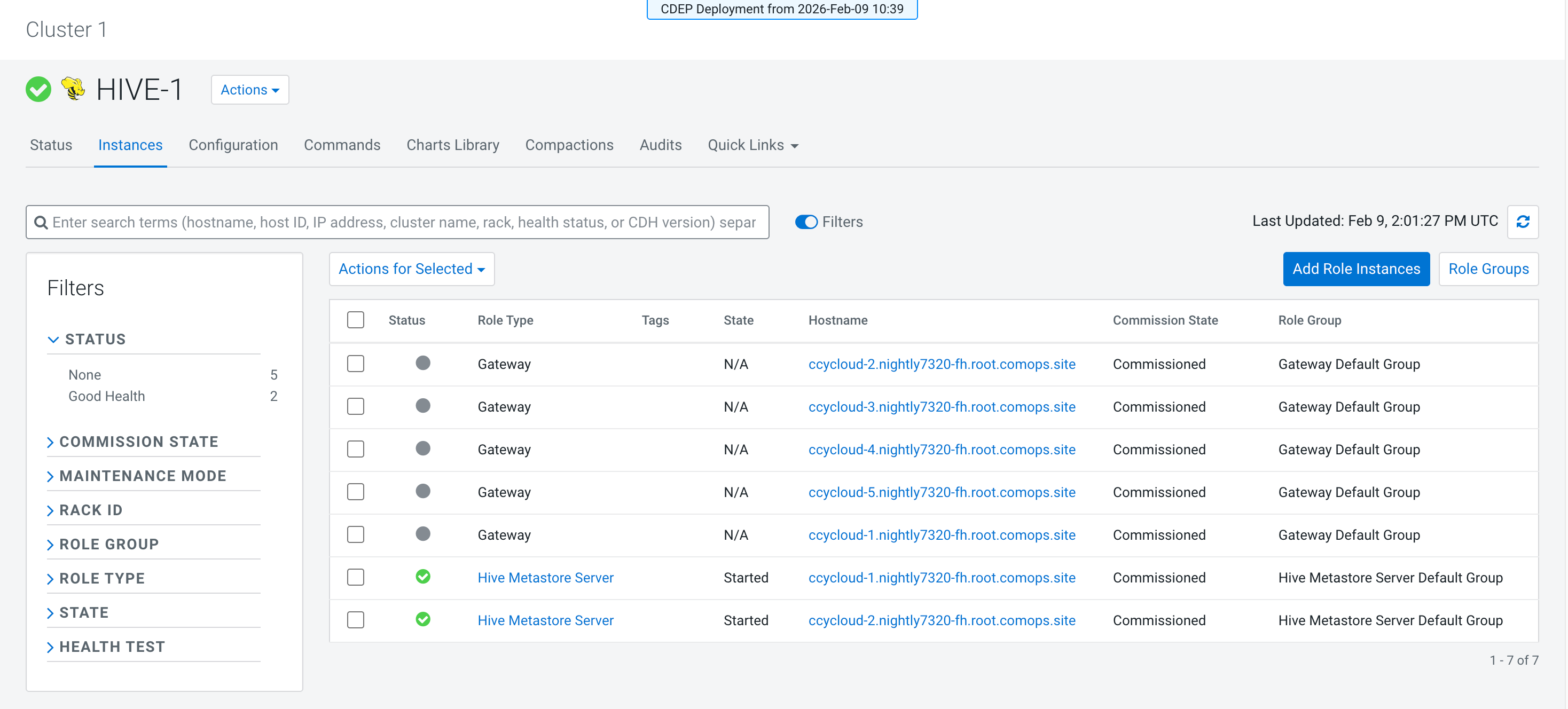

  • HMS Host URL (multiple if high availability is used): Go to Cloudera Manager > Clusters > HIVE-1 > Instances, and note down each hostname with role type Hive Metastore Server.

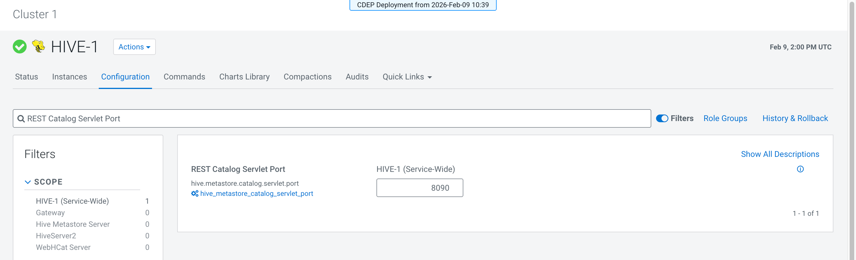

  • HMS REST Catalog Servlet Port: Go to Cloudera Manager > Configuration, then search for REST Catalog Servlet Port and note down the port number.

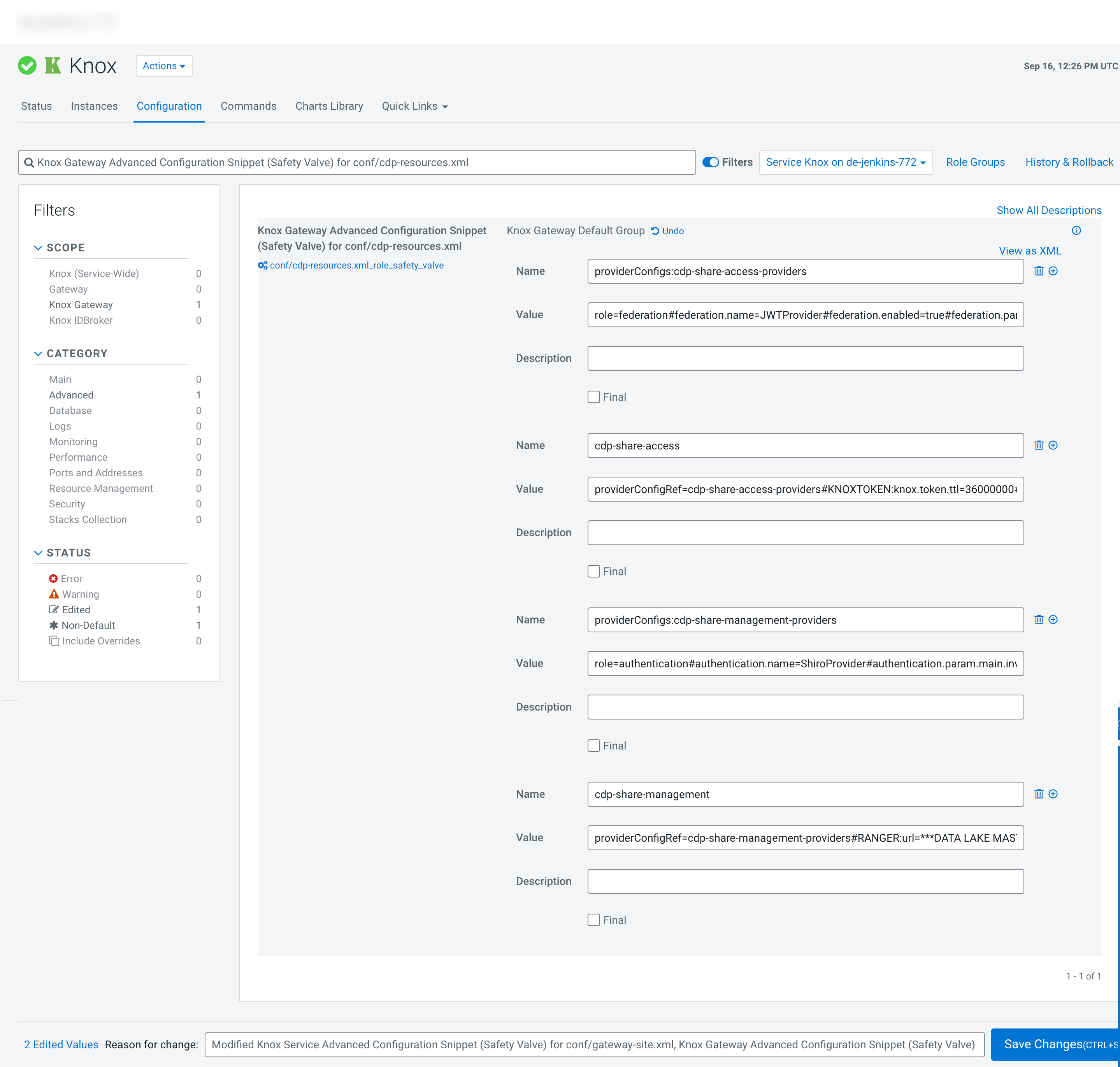

  1. Go to Cloudera Manager > Knox > Configuration.
  2. Select the Knox Gateway scope.
  3. Search for and edit the Knox Gateway Advanced Configuration Snippet (Safety Valve) for conf/cdp-resources.xml property, and add the following after clicking View as XML:
    <property>
        <name>providerConfigs:cdp-share-access-providers</name>
        <value>role=federation#federation.name=JWTProvider#federation.enabled=true#federation.param.knox.token.exp.server-managed=true#role=identity-assertion#identity-assertion.name=Default#identity-assertion.enabled=true#identity-assertion.param.group.mapping.$PRIMARY_GROUP=(not(member username))#role=ha#ha.name=HaProvider#ha.param.HMS-API=enabled=true;maxFailoverAttempts=3;failoverSleep=1000#identity-assertion.param.hadoop.proxyuser.<varname>[***USERNAME***]</varname>.users=#identity-assertion.param.hadoop.proxyuser.<varname>[***USERNAME***]</varname>.groups=#identity-assertion.param.hadoop.proxyuser.<varname>[***USERNAME***]</varname>.hosts=*</value>
    </property>
    <property>
        <name>cdp-share-access</name>
        <value>providerConfigRef=cdp-share-access-providers#KNOXTOKEN:knox.token.ttl=36000000#KNOXTOKEN:knox.token.exp.server-managed=true#HMS-API:url=http://<varname>[***HMS-HOST***]</varname>:<varname>[***REST CATALOG SERVLET PORT***]</varname>#</value>
    </property>
    <property>
        <name>providerConfigs:cdp-share-management-providers</name>
        <value>role=authentication#authentication.name=ShiroProvider#authentication.param.main.invalidRequest=org.apache.shiro.web.filter.InvalidRequestFilter#authentication.param.main.invalidRequest.blockBackslash=false#authentication.param.main.invalidRequest.blockNonAscii=false#authentication.param.main.invalidRequest.blockSemicolon=false#authentication.param.main.pamRealm=org.apache.knox.gateway.shirorealm.KnoxPamRealm#authentication.param.main.knoxAnonFilter=org.apache.knox.gateway.filter.AnonymousAuthFilter#authentication.param.urls./knoxtoken/api/v1/jwks.json=knoxAnonFilter#authentication.param.main.pamRealm.service=login#authentication.param.sessionTimeout=30#authentication.param.urls./**=authcBasic#role=identity-assertion#identity-assertion.name=HadoopGroupProvider#identity-assertion.param.hadoop.proxyuser.impersonation.enabled=true#identity-assertion.param.hadoop.proxyuser.<varname>[***USERNAME***]</varname>.users=*#identity-assertion.param.hadoop.proxyuser.<varname>[***USERNAME***]</varname>.groups=*#identity-assertion.param.hadoop.proxyuser.<varname>[***USERNAME***]</varname>.hosts=*#identity-assertion.param.CENTRAL_GROUP_CONFIG_PREFIX=gateway.group.config.#role=authorization#authorization.name=XASecurePDPKnox#authorization.enabled=false#role=ha#ha.name=HaProvider#ha.enabled=true#ha.param.RANGER=enableStickySession=false;noFallback=false;enableLoadBalancing=true</value>
    </property>
    <property>
        <name>cdp-share-management</name>
        <value>providerConfigRef=cdp-share-management-providers#RANGER:url=https://<varname>[***RANGER-HOST***]</varname>:<varname>[***RANGER SERVLET PORT***]</varname>#KNOXTOKEN:knox.token.ttl=-1#KNOXTOKEN:knox.token.type=JWT#KNOXTOKEN:knox.token.target.url=cdp-proxy-token#KNOXTOKEN:knox.token.audiences=cdp-proxy-token#KNOXTOKEN:knox.token.client.data=homepage_url=homepage/home?profile=token&amp;amp;topologies=cdp-proxy-token#KNOXTOKEN:knox.token.exp.tokengen.allowed.tss.backends=JDBCTokenStateService,AliasBasedTokenStateService#KNOXTOKEN:knox.token.lifespan.input.enabled=true#KNOXTOKEN:knox.token.user.limit.exceeded.action=RETURN_ERROR#KNOXTOKEN:knox.token.exp.server-managed=true</value>
    </property>
    <property>
    </property>
    <property>
        <value>providerConfigRef=cdp-share-access-providers#KNOXTOKEN:knox.token.ttl=36000000#KNOXTOKEN:knox.token.exp.server-managed=true#HMS-API:url=http://<varname>[***HMS-HOST1***]</varname>:<varname>[***REST CATALOG SERVLET PORT***]</varname>#HMS-API:url=http://<varname>[***HMS-HOST2***]</varname>:<varname>[***REST CATALOG SERVLET PORT***]</varname>#</value>
    </property>
    <property>
    </property>
    <property>
        <value>providerConfigRef=cdp-share-management-providers#RANGER:url=https://<varname>[***RANGER-HOST1***]</varname>:<varname>[***RANGER SERVLET PORT***]</varname>#RANGER:url=https://<varname>[***RANGER-HOST2***]</varname>:<varname>[***RANGER SERVLET PORT***]</varname>#KNOXTOKEN:knox.token.ttl=-1#KNOXTOKEN:knox.token.type=JWT#KNOXTOKEN:knox.token.target.url=cdp-proxy-token#KNOXTOKEN:knox.token.audiences=cdp-proxy-token#KNOXTOKEN:knox.token.client.data=homepage_url=homepage/home?profile=token&amp;amp;topologies=cdp-proxy-token#KNOXTOKEN:knox.token.exp.tokengen.allowed.tss.backends=JDBCTokenStateService,AliasBasedTokenStateService#KNOXTOKEN:knox.token.lifespan.input.enabled=true#KNOXTOKEN:knox.token.user.limit.exceeded.action=RETURN_ERROR#KNOXTOKEN:knox.token.exp.server-managed=true</value>
    </property>
    Figure 1. Knox topology parameters in the configuration editor after pasting as XML
    #identity-assertion.param.hadoop.proxyuser.[***USERNAME***].users=*#
    identity-assertion.param.hadoop.proxyuser.[***USERNAME***].groups=*#
    identity-assertion.param.hadoop.proxyuser.[***USERNAME***].hosts=*
    The relevant Knox topologies are created.
  4. Click Save Changes and refresh the configuration as needed.
