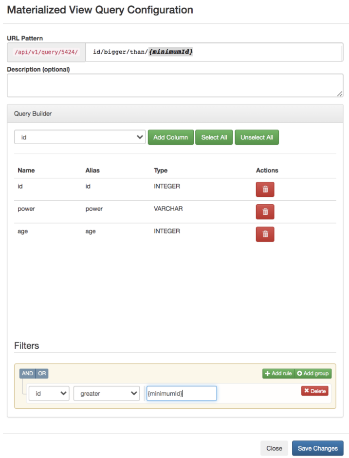

In case of a dynamic endpoint, you have the option to set dynamic variables in the endpoint URL. This means that when providing the information in the URL pattern field, you also include a generic variable that later can be specified when using the REST endpoint. With dynamic endpoints, you can further filter the queried results based on the given variable. When creating the dynamic endpoint, you need to make sure that the variable is surrounded by curly braces to signal that it is a variable as minimumId in the example shown below. You also need to reference the variable in the same way when setting the Filters for the Materialized View Query. For example, in the following dynamic endpoint the Filter is set to id greater than {minimumId}, and the endpoint URL is id/bigger/than/{minimumId}:

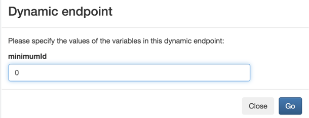

When you click on a dynamic endpoint, you are prompted to provide a value for the variable as shown in the following illustration:
After entering a value, the filtered results are shown in a new browser tab:
The advantage of a dynamic endpoint is that by providing a variable in the URL, you are able to narrow the queried results to the value you exactly need from that dataset. In the following example, the minimumId variable is set to 5, so the "id" of the shown entries are bigger than 5:
