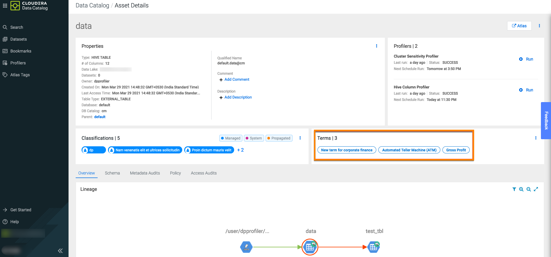

When you map a specific term for your dataset, the term is displayed in the following format:
<termname>@glossaryname>
Figure 1. Glossary term in Search
Figure 2. Glossary term in Asset Details

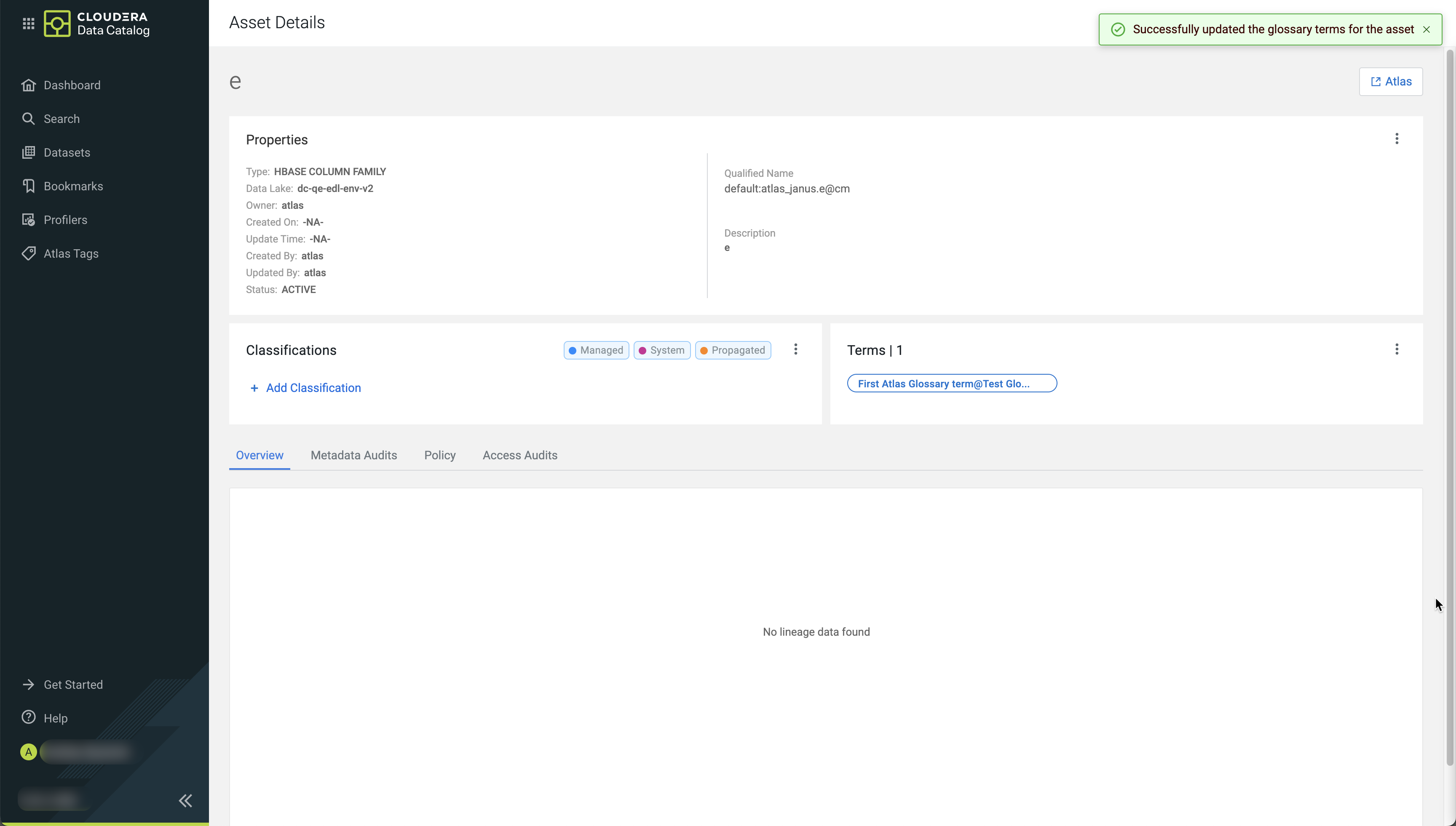

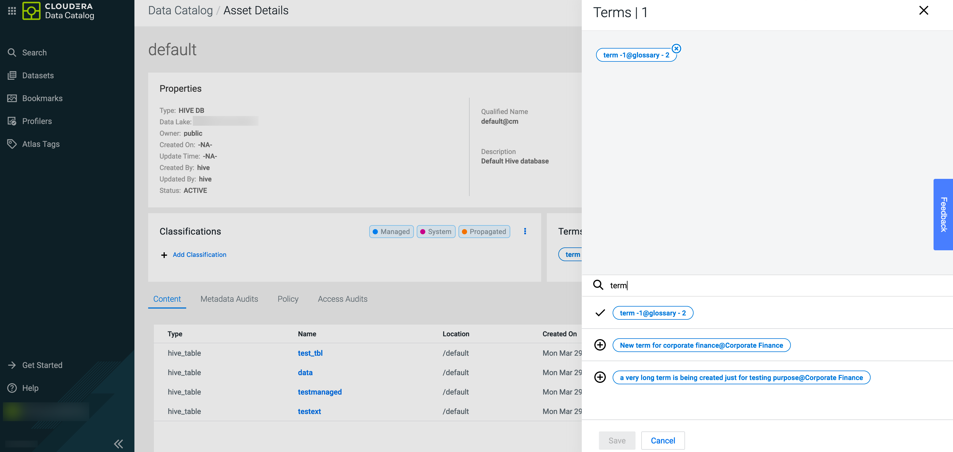

You can use the icon in the Terms widget on the Asset Details page to add new terms for your assets. Click Save to save the changes.
Figure 3. Mapping terms in Asset Details
Figure 4. Mapped glossary term

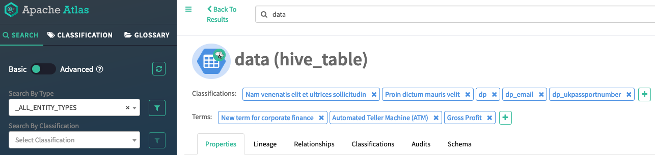

You can search for the same asset in the corresponding Atlas environment as shown in the example image.

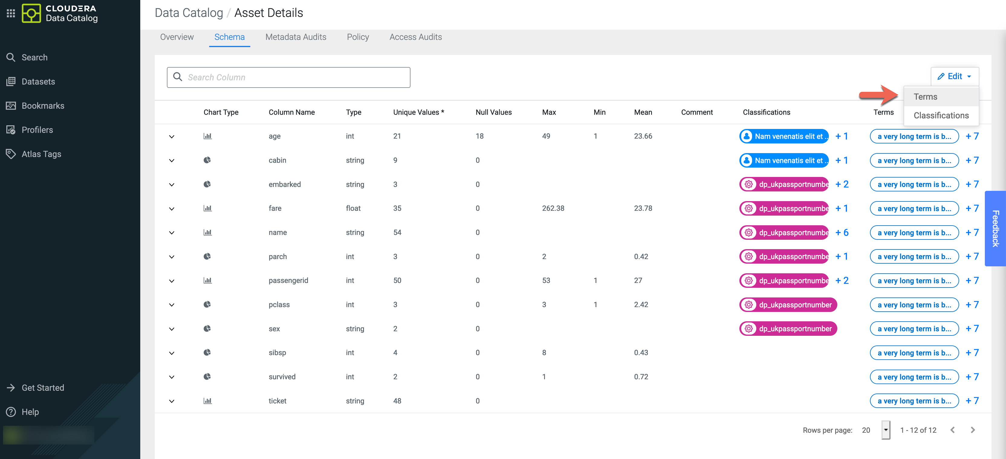

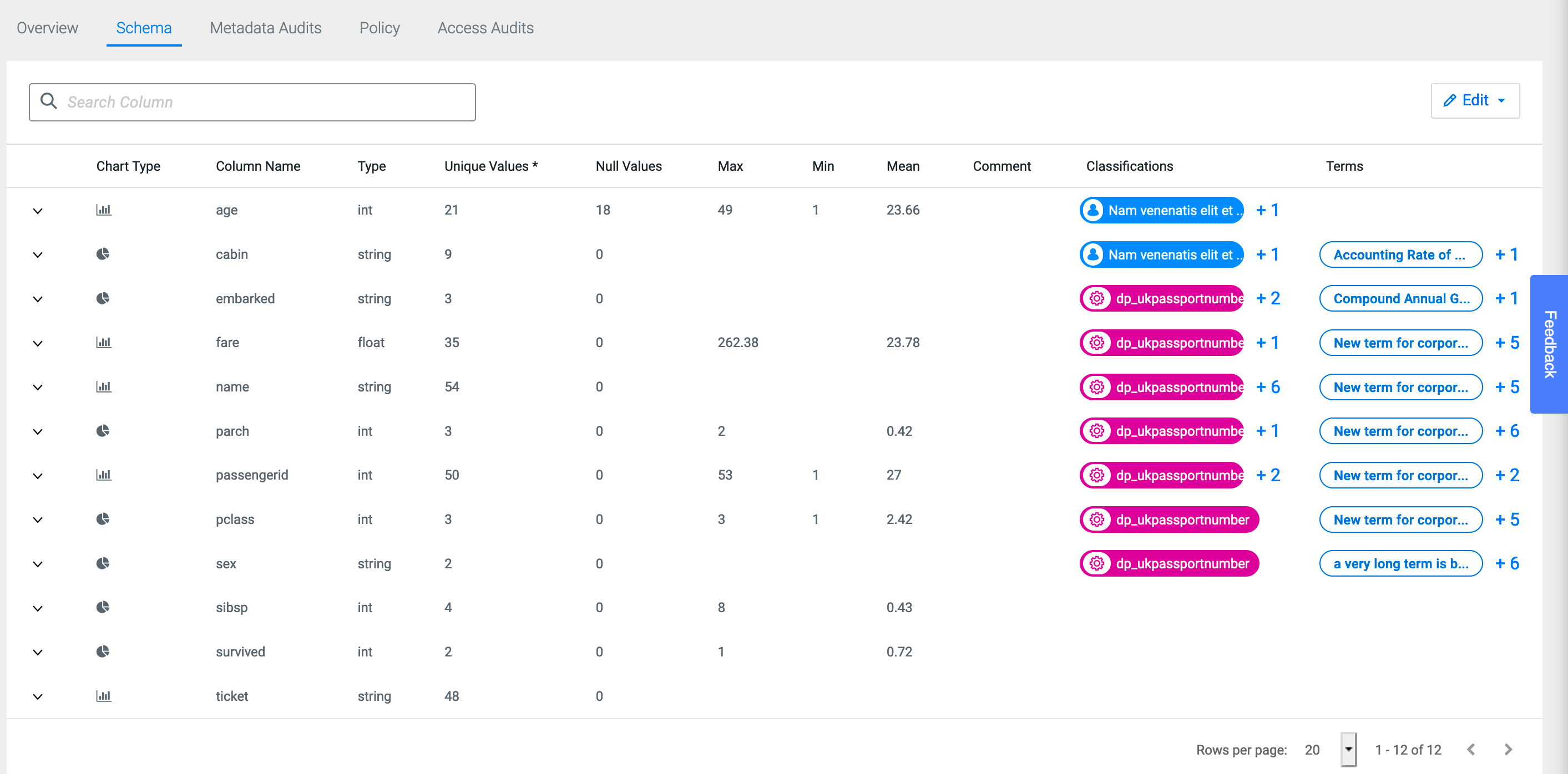

When you select a Hive table asset and navigate to the Asset Details page, under the Schema tab, you can view the list of terms associated with the asset.
You can add or update the terms for the associated datasets by clicking the Edit button.
