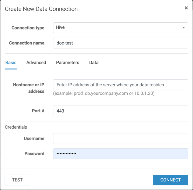

On the side menu bar, click New Connection.
The Create New Data Connection side panel appears.
Choose Hive from the Connection type drop-down list and
assign a name to your connection.
Enter the hostname or IP address of the running coordinator.
You can get the coordinator hostname from the JDBC URL of the Hive Data
Warehouse.
Add the respective port number in the Port # field.
In this example 443 is used.
Enter your workload username and password as credentials.

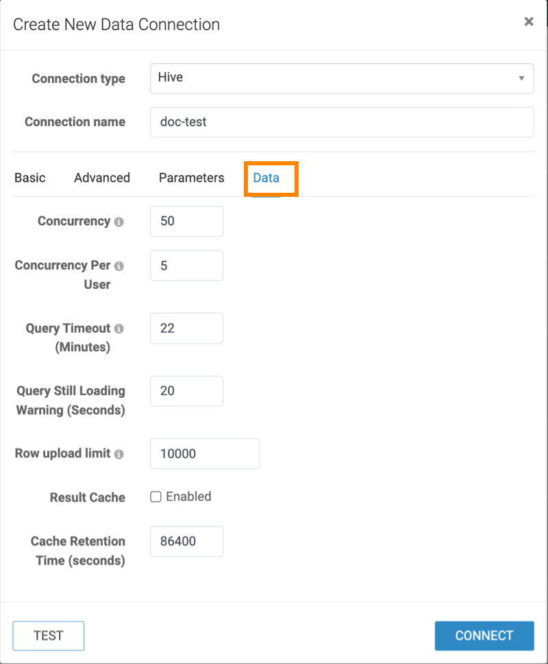

Check the Data tab for more configuration options.
