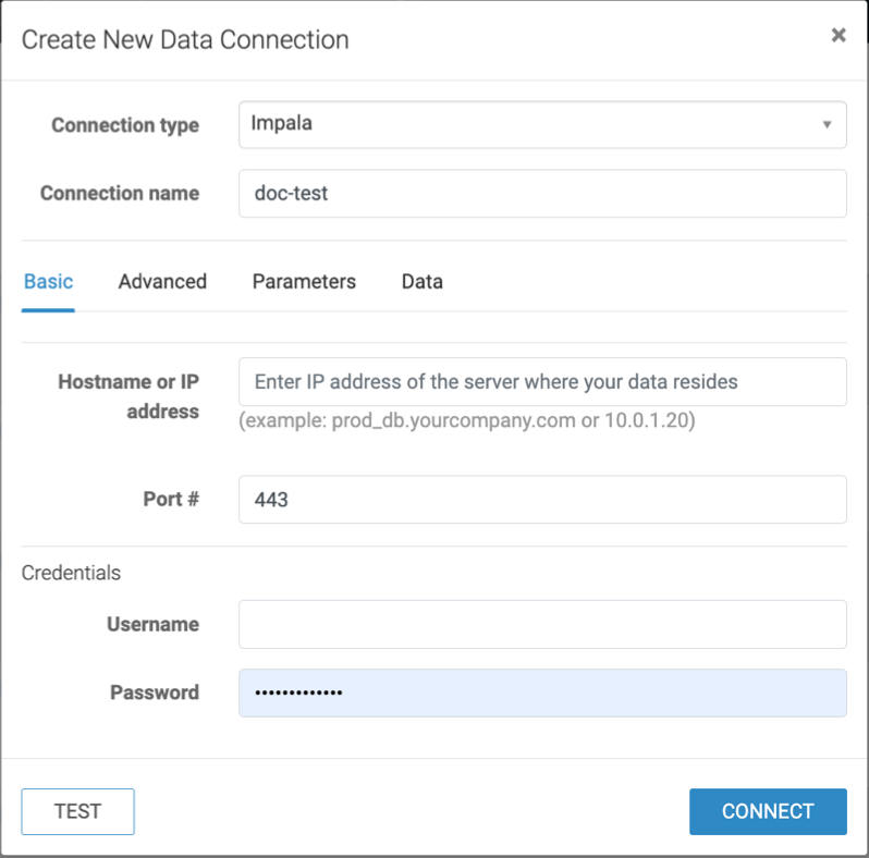

  3. Choose Impala from the Connection type drop-down list and assign a name to your connection.
  4. Enter the hostname or IP address of the running coordinator.
    You can retrieve this information from the JDBC URL of the Impala DW.
  5. Add the respective port number in the Port # field.
    In this example, the Impala connection is made through Knox. Knox always uses TLS encryption and port 443 is the default HTTPS port.
  6. Enter your workload username and password as credentials.

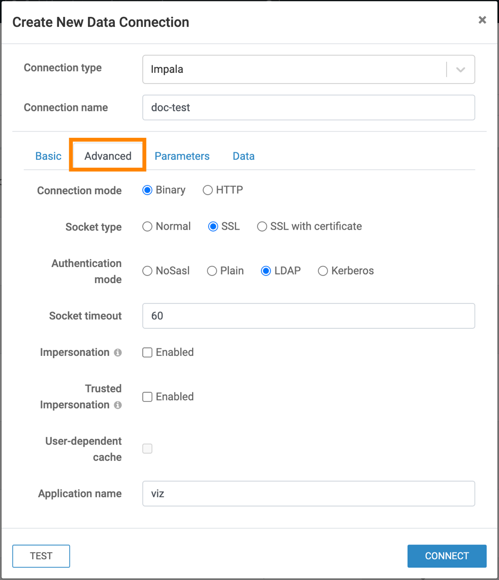

  7. Click the Advanced tab to configure additional details.

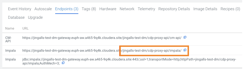

    1. For HTTP connection mode, locate the Impala Endpoint for the Data Hub.
    2. Copy and paste it into the HTTP Path field.
    3. Set any additional details as required.

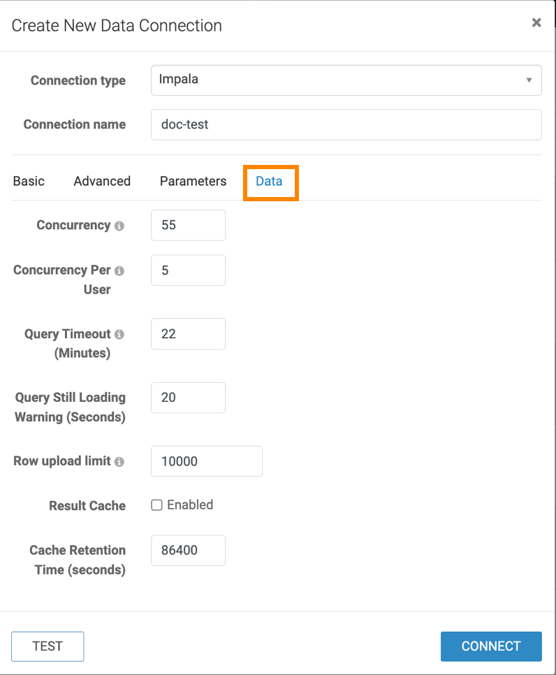

  8. Check the Parameters and Data tabs for more configuration options.
