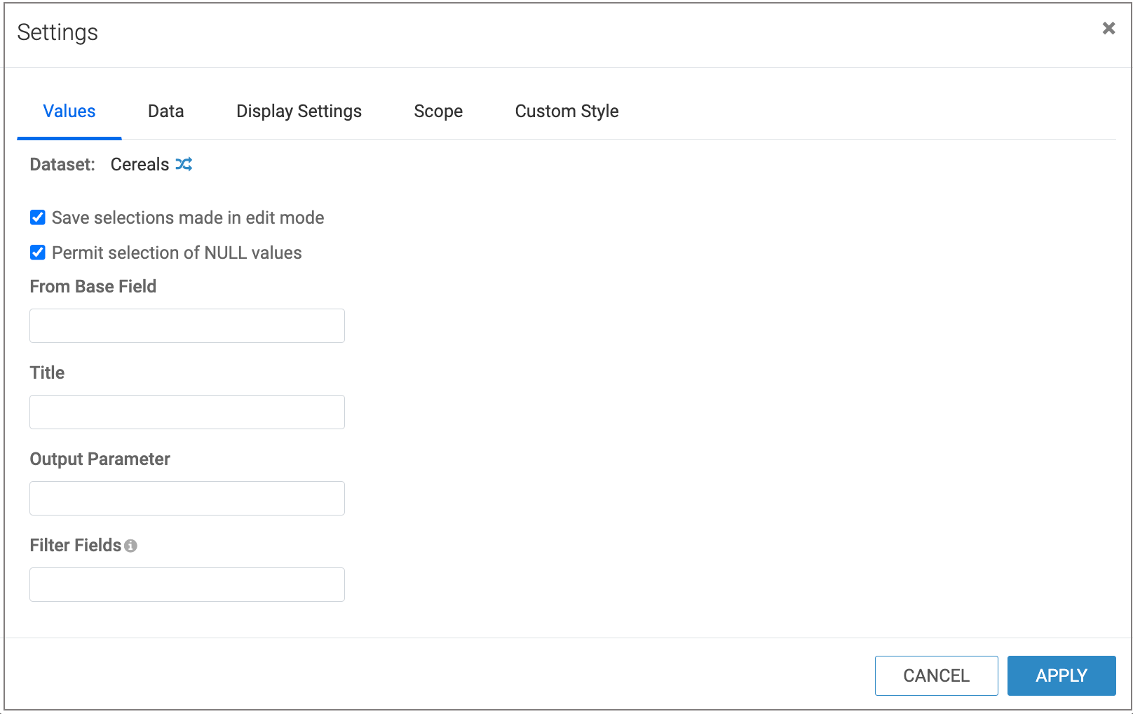

  4. To set the basic configuration for the new dashboard filter, click in the top right corner.
    The Settings modal window opens on the Values tab, showing the dataset of the filter and several configuration options.
    1. To switch the filter to another dataset and connection, click .
    2. To preserve the adjusted filter settings for View mode, select the Save selections made in edit mode option. You can use it to save all changes made in Edit mode.
    3. To exclude null values for all filter types, use the Permit selection of NULL values setting.
    4. From Base field specifies the filter-controlling field. You can change the base field to another field of the dataset. This option is available only in dataset-based filters.
    5. Title shows the name of the filter as it appears in the application at run-time. Keep it short and descriptive providing information on the filter's function.
    6. Output Parameter is the parameter sent to the target visual to determine which field to display. For optional or variable parameters, output parameter is used on the shelves of the target visual, such as <<[dim], or <<[agg], or in an expression that contains the variable.
      When used in filters that are based on existing fields, the output parameter ensures field name match across datasets. For example, a filter that is based on the state field in the US State Populations Over Time dataset must have the output parameter stname to control visuals in the US County Population dataset.
    7. Filter Fields specifies the base fields of another field, based on which options of the current filter can be filtered. You can enter multiple base fields separated by a comma. This option is available only in dataset-based filters.
  5. Click APPLY to save the configuration settings.
