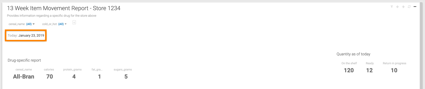

        Add time stamp.
            Create the extension visual using the following definition:

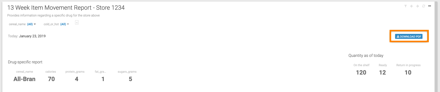

<span style="color:#aaa">Today:</span> <span id="tdate"></span> <script> $(document).ready(function() { var today = new Date(); $('#tdate').html( $.datepicker.formatDate('MM dd, yy', today)); }); </script>When you add this extension visual to the dashboard, it will look similar to this (in View mode).

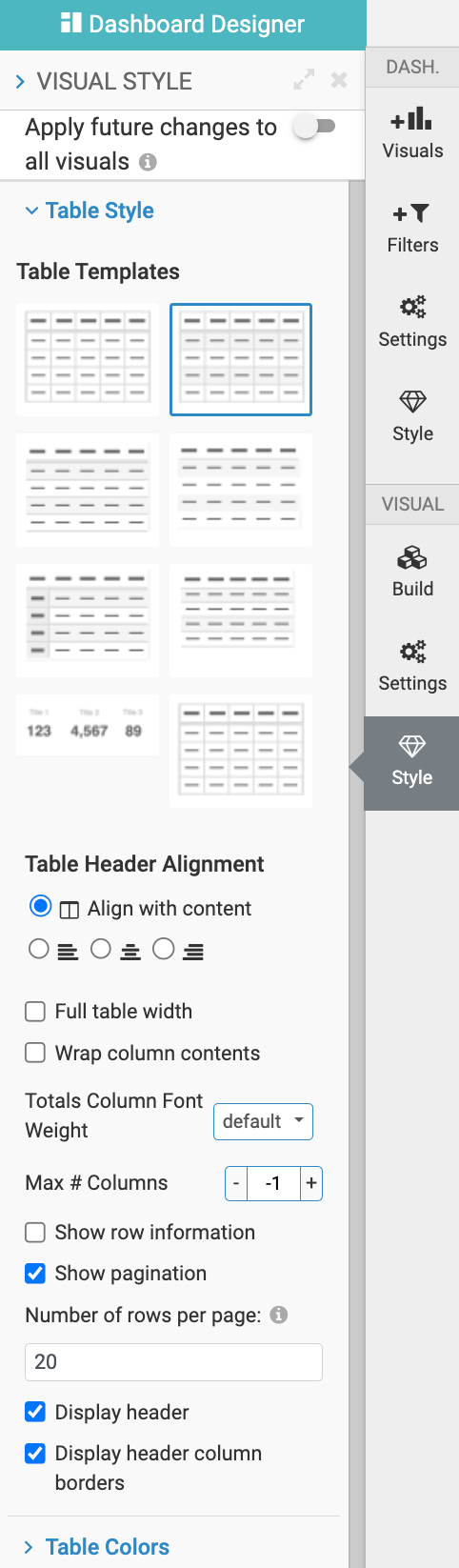

- Create the table visual on the target dataset. For more information, see Tables.
 - On the right side of Visual Designer, click the Style menu.
 - In the Style menu, click Table Style.
            In the Table Style menu, make the following selections and
              changes:
- Choose the first table template
 - Table Header Alignment set to Align with contents
 - Enable Full Table Width
 - Wrap Column Contents

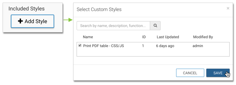

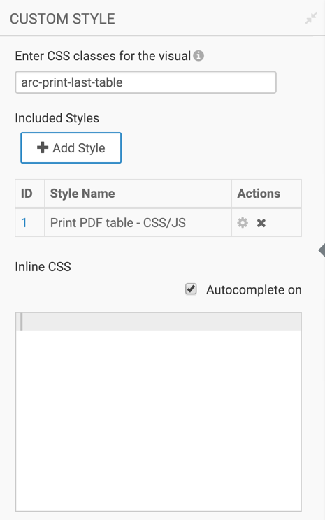

- Add the style arc-print-last-table to the visual. For more information, see Adding custom styles to visuals .
Add the style we created earlier, Print PDF table - CSS/JS, to the visual. For more information, see Adding included styles to visuals .
Your Custom Style menu selections should look something like this:

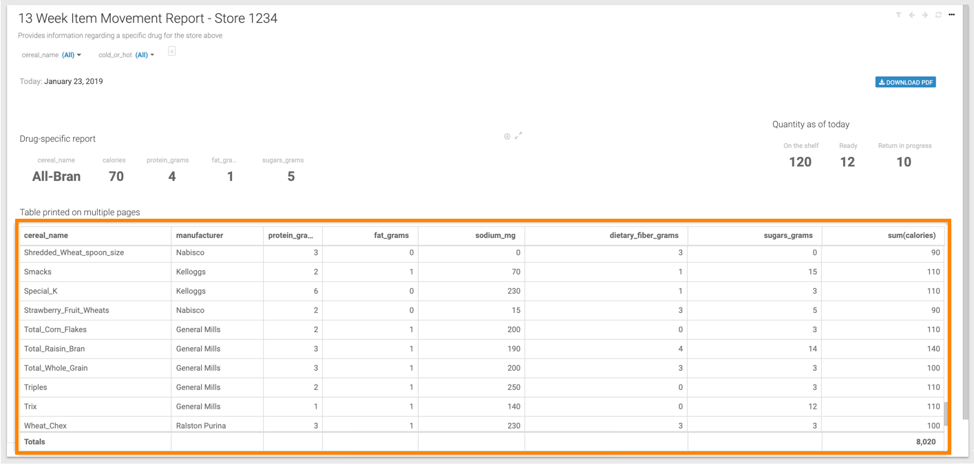

            When you finished configuring the table, it would look similar to this in
                View mode of the dashboard. Ensure that this table visual is
              the last item on the dashboard.

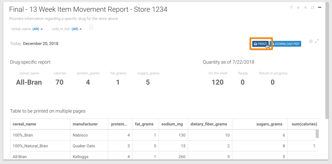

            Click PRINT on the dashboard, and then follow system prompts
              to complete the printing process.

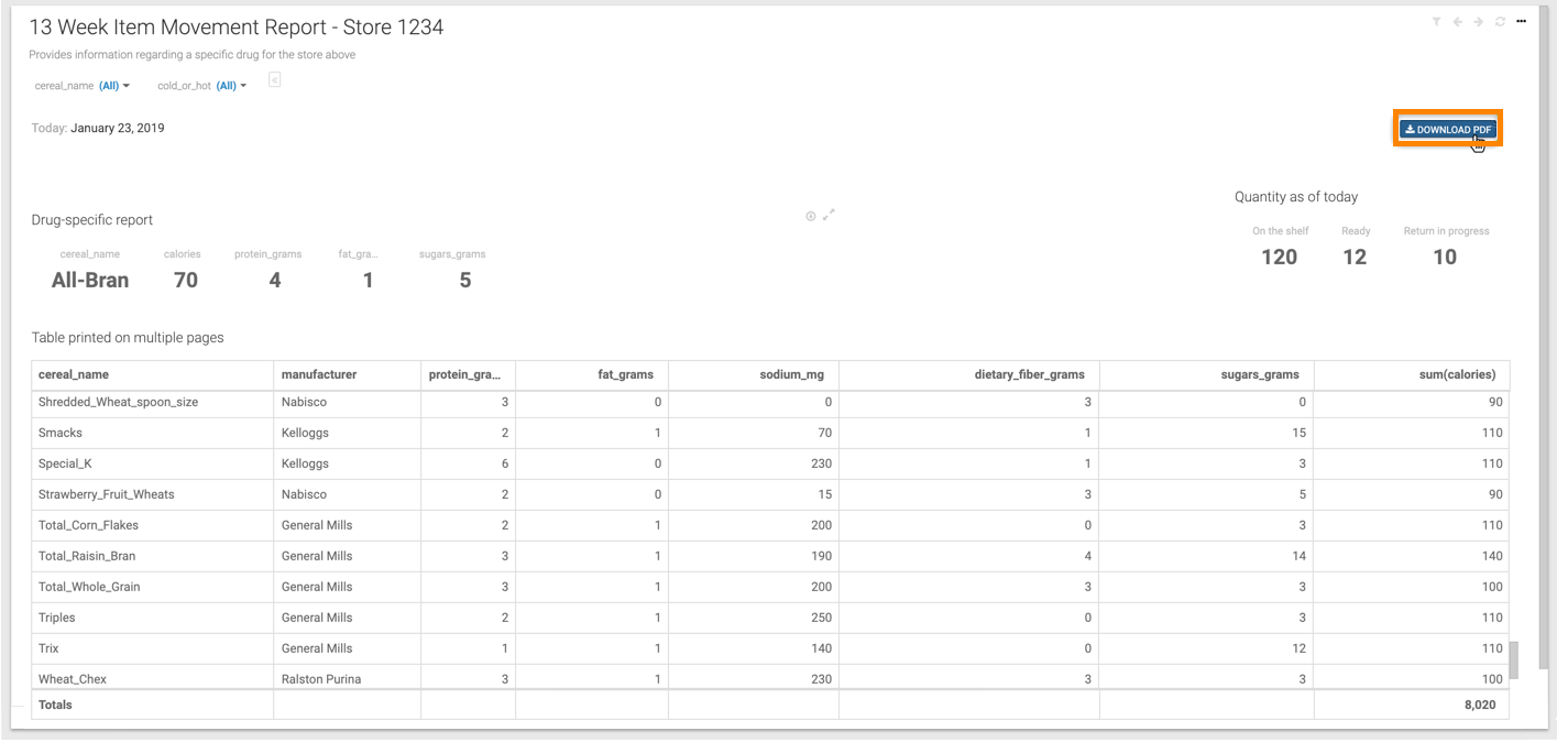

            Click DOWNLOAD PDF on the dashboard, and then follow system
              prompts to complete the PDF download of the dashboard.
