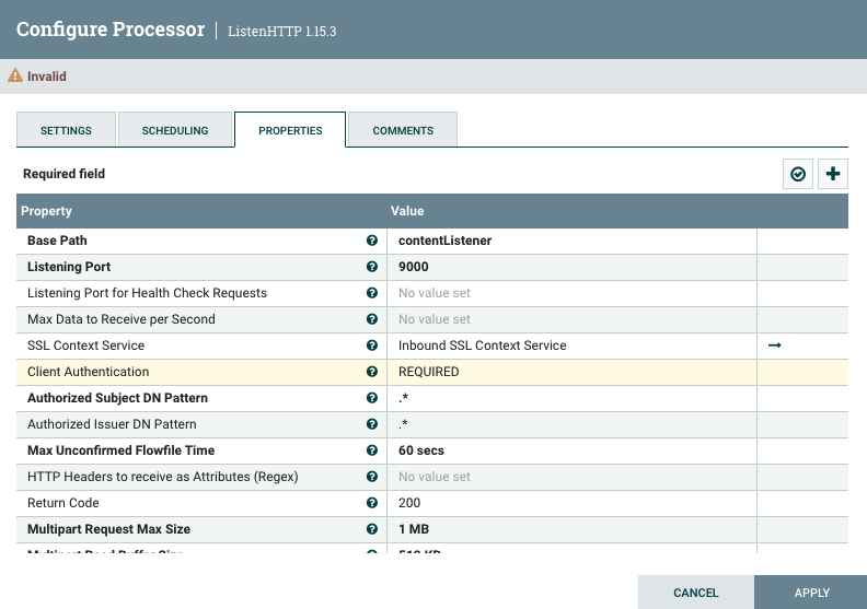

  5. Configure the listen processor:
    Base Path
    This tutorial uses the default contentListener.
    Listening Port
    Define a value that is valid for your use case. This tutorial uses port 9000.
    SSL Context Service
    Select Inbound SSL Context Service.
    Client Authentication
    Select REQUIRED.
    Click Apply.

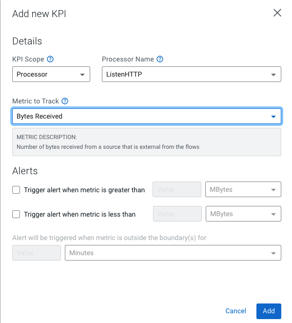

    4. Add a KPI on the ListenHTTP processor to monitor how many bytes it is receiving, by clicking Add new KPI.
      Make the following settings:
      KPI Scope
      Processor
      Processor Name
      ListenHTTP
      Metric to Track
      Bytes Received

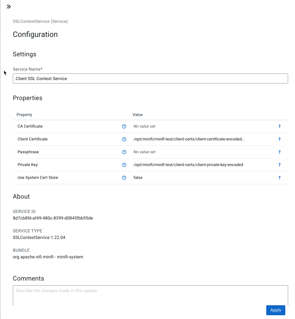

    2. Create a Service of type SSL Context Service with the following configuration:
      Service Name
      Specify a name for this service. This tutorial uses Client SSL Context Service.
      CA Certificate
      Leave it empty. As Cloudera Data Flow uses Let's Encrypt as a Certificate Authority, the certificate will be accepted automatically, without additional configuration.
      Client Certificate
      [***/PATH/TO/***]client-certificate-encoded.cer
      For example, /opt/minifi/minifi-test/client-certs/client-certificate-encoded.cer.
      Passphrase
      Set no value.
      Private Key
      [***PATH/TO/***]client-private-key-encoded
      For example, /opt/minifi/minifi-test/client-certs/client-private-key-encoded
      Use System Cert Store
      Keep the default False value.
    3. Click Apply.

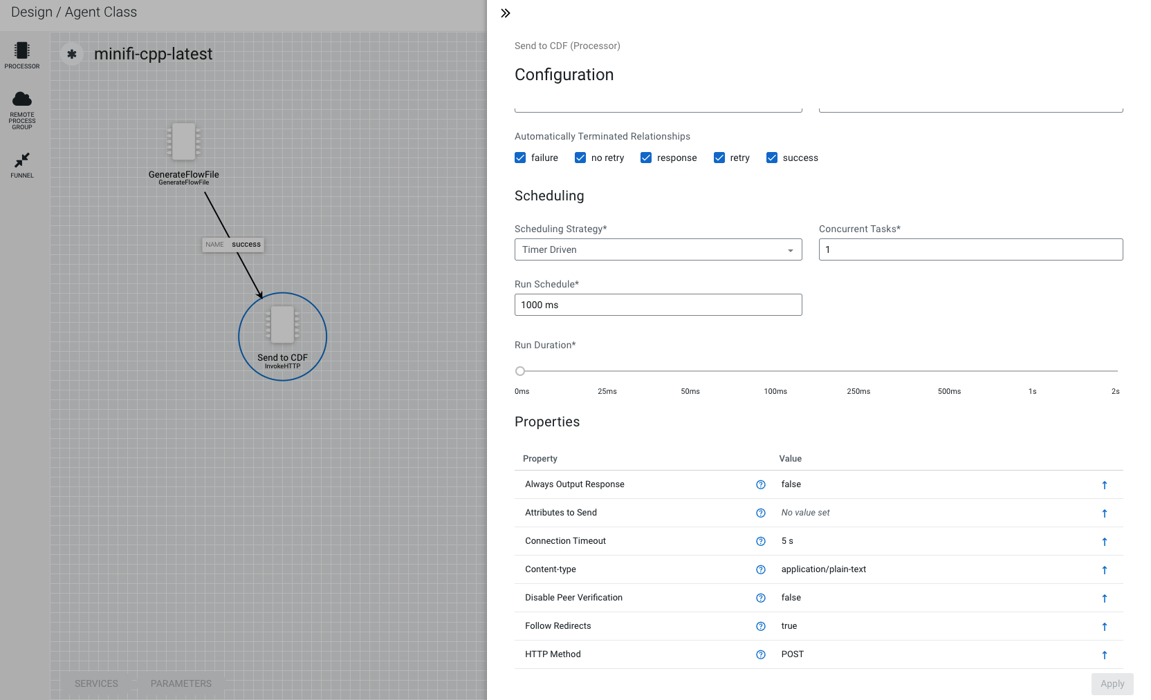

    4. Create an InvokeHTTP processor named Send to CDF with the following configuration:
      Automatically Terminated Relationships
      Select all relationships.
      Content-type
      Depends on your flow file data type. This tutorial uses text/plain.
      HTTP Method
      POST
      Remote URL
      https://[***ENDPOINT HOSTNAME COPIED FROM CLOUDERADATAFLOW FLOW DEPLOYMENT MANAGER***]:9000/contentListener
      For example, https://my-flow.inbound.my-dfx.c94x5i9m.xcu2-8y8z.mycompany.test:9000/contentListener
      SSL Context Service
      Leave all other settings with their default values.

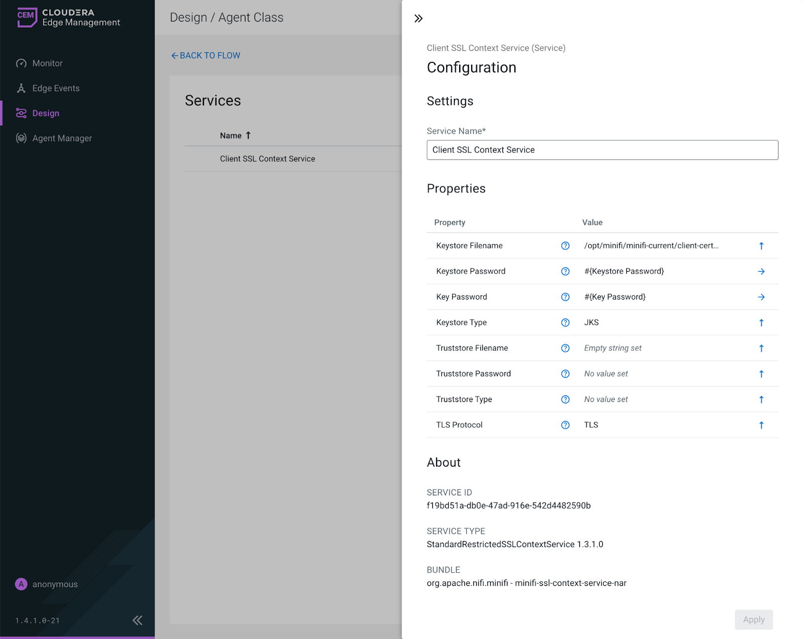

    4. Create a Service of type Restricted SSL Context Service with the following configuration:
      Service Name
      Keystore Filename
      [***/PATH/TO/***]client-truststore.jks
      Keystore Password
      [***THE PASSWORD YOU PROVIDED WHEN CREATING THE JKS STORE***]
      Key Password
      Keystore Type
      JKS
      Truststore Filename
      Truststore Type
      JKS
      Truststore Password
      [***THE PASSWORD YOU PROVIDED WHEN CREATING THE CLIENT TRUSTSTORE***]
    5. Click Apply.

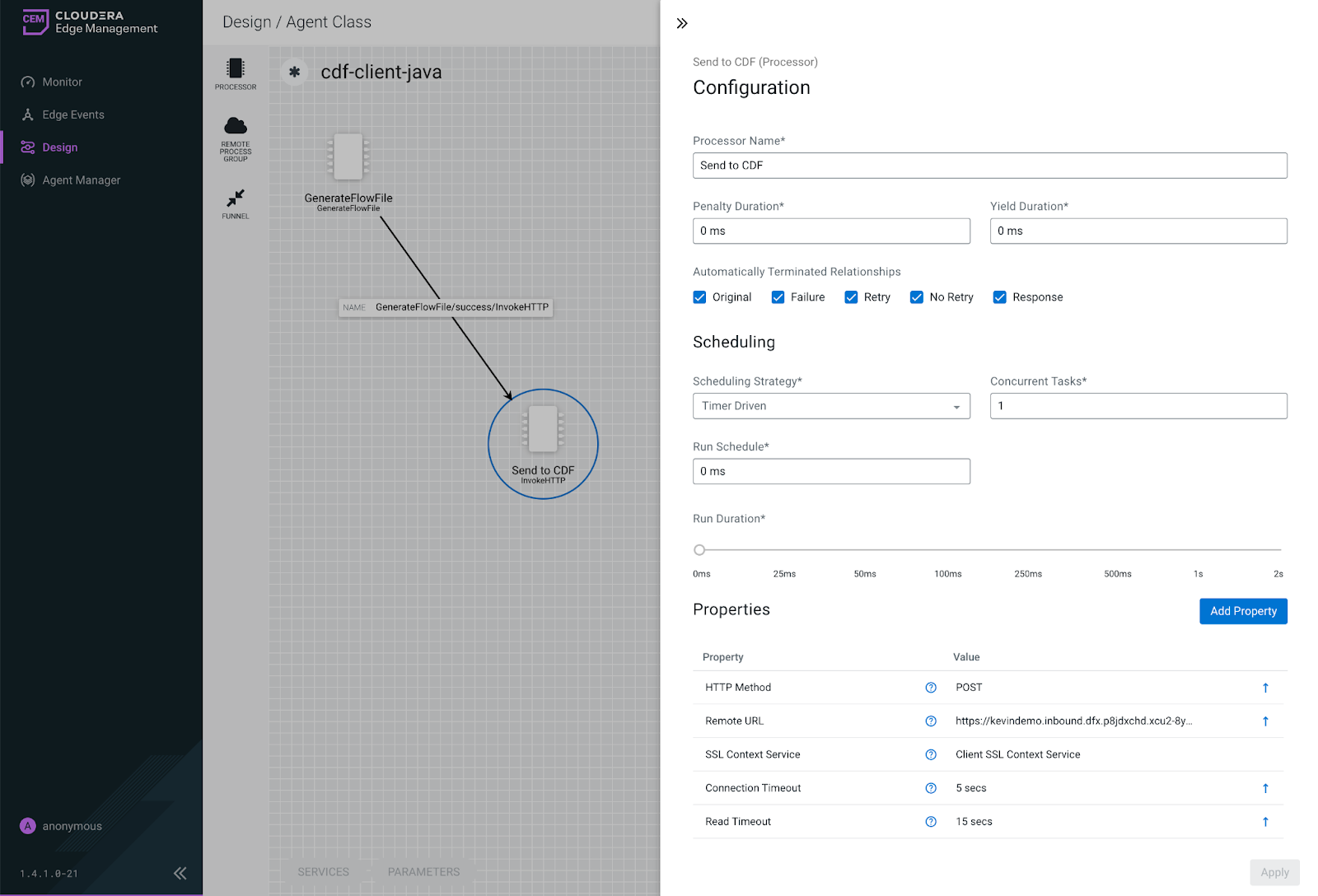

    6. Create an InvokeHTTP processor named Send to CDF with the following configuration:
      Content-type
      HTTP Method
      POST
      Remote URL
      https://[***ENDPOINT HOSTNAME COPIED FROM CLOUDERA DATAFLOW FLOW DEPLOYMENT MANAGER***]:9000/contentListener
      SSL Context Service

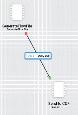

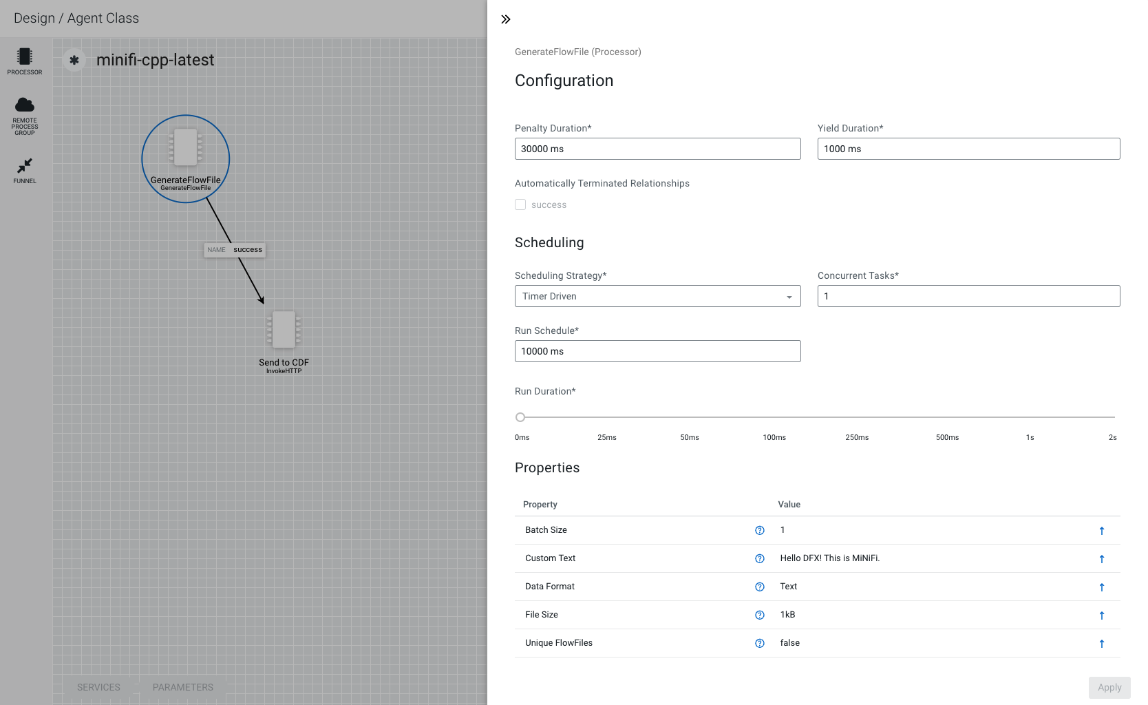

  12. Build the rest of your data flow to read data and send to your Cloudera Data Flow flow deployment using InvokeHTTP. As a simple example, this tutorial uses the GenerateFlowFile processor, with the following settings:
    Run Schedule
    Set to 10000 ms (10 seconds).
    Custom Text
    The message you type here will be sent to the ListenHTTP Flow you have created, with the frequency specified by Run Schedule. For example, Hello DFX! This is MiNiFi.
    Data Format
    Set to Text.
    Unique FlowFiles
    Set to false.
  13. Connect the GenerateFlowFile processor to the InvokeHTTP processor.
  14. Click Actions > Publish...to publish the flow and start it on your MiNiFi agent.
