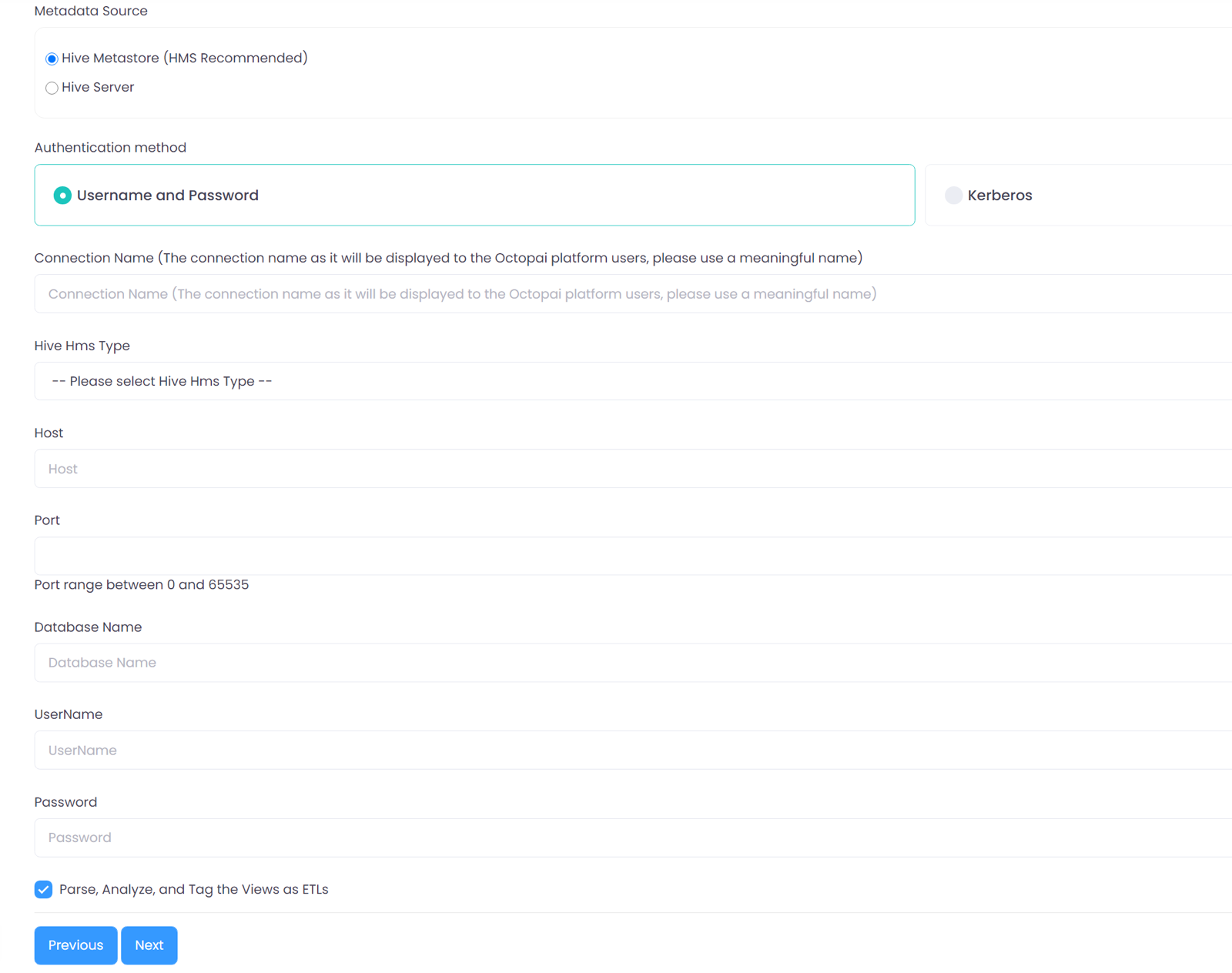

    • For Username and Password, enter the UserName and Password.

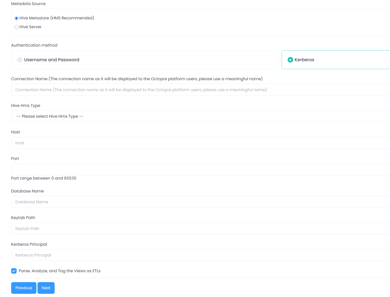

    • For Kerberos, enter the Keytab Path and Kerberos Principal.
    Figure 1. HMS metadata source with Username and Password authentication
    New Metadata Source wizard with Hive Metastore selected, Username and Password authentication, and the Connection Name, Hive Hms Type, Host, Port, Database Name, UserName, and Password fields.
    Figure 2. HMS metadata source with Kerberos authentication
    New Metadata Source wizard with Hive Metastore selected, Kerberos authentication, and the Connection Name, Hive Hms Type, Host, Port, Database Name, Keytab Path, and Kerberos Principal fields.

Hive Hms Type Postgres N/A
Host hms-db.example.com From your administrator
Port 5432 From your administrator
Database Name hms From your administrator
Kerberos Principal my-service@YOUR.REALM Kerberos only
Keytab Path C:\Octopai\keytabs\my-service.keytab Kerberos only
UserName and Password From your administrator Password authentication only; not used for Kerberos
For Kerberos connections, you enter only the principal and keytab. Octopai Client derives the PostgreSQL login role from the principal: the part before @, with hyphens changed to underscores. For example, my-service@REALM becomes the role my_service. Your administrator must create or map that role to match your principal.

For password authentication, use a SQL username and password. Password authentication must be enabled in pg_hba.conf for your client IP address. If login fails with a correct password, ask your administrator to verify that the pg_hba.conf authentication settings match how the password was created.
