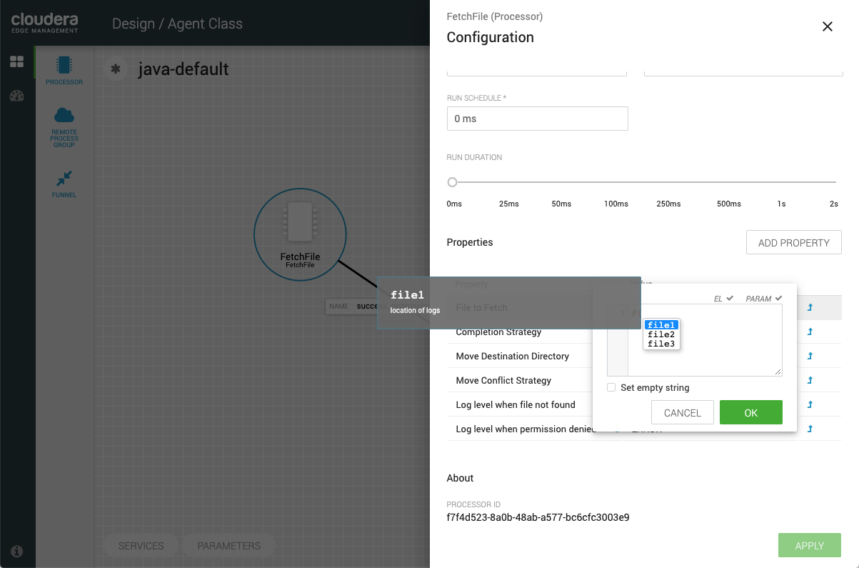

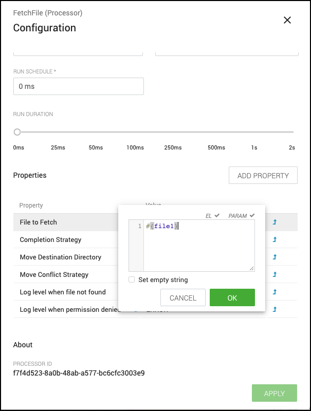

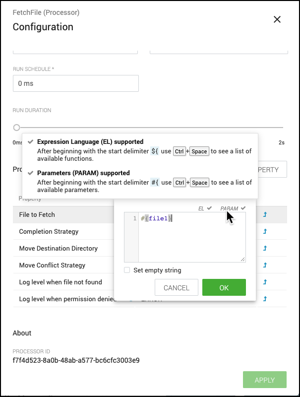

  1. To reference an existing parameter, select the property value field and clear the default value if one exists.
  2. Enter the start delimiter #{.
  3. If you know the parameter you want to reference, enter its name. Alternatively, select the keystroke control+space to show the list of available parameters:
  4. Complete the entry with a closing curly brace } and select OK.
  5. Click APPLY to save the changes.
    Help text describing this process appears when you hover over the Expression Language and Parameters eligibility indicators.

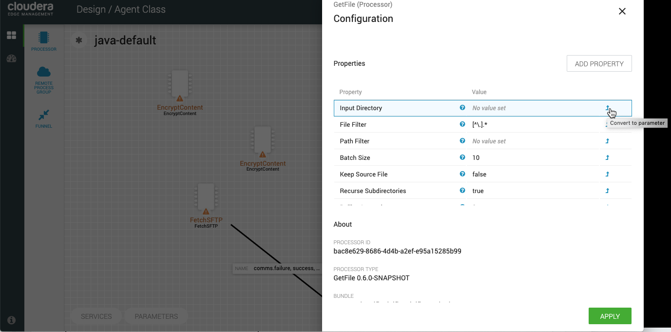

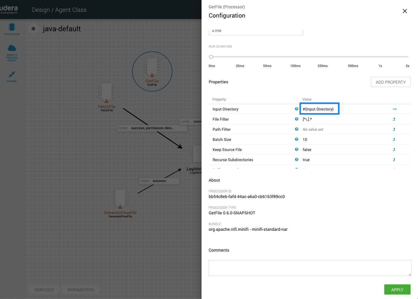

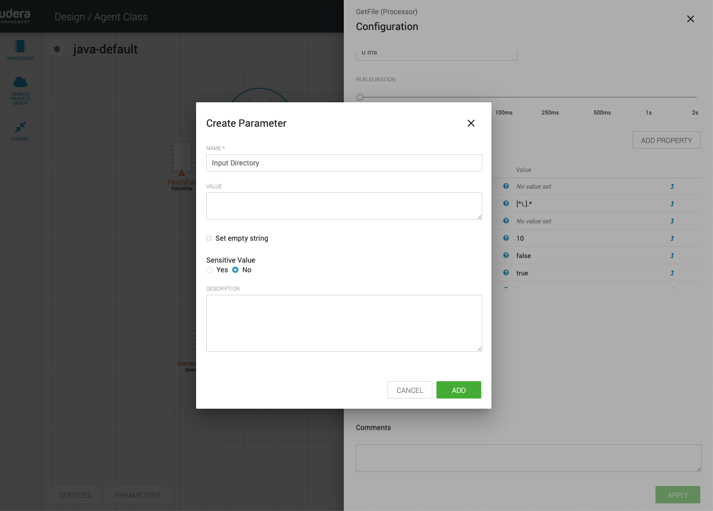

Parameters can be created during process or service configuration. Instead of entering a property value, you can convert the property value to a parameter.
  1. To create a parameter for a property value, select the Convert to parameter icon () in the row of that property.
    The Create Parameter dialog appears as shown in the following image:
  2. Configure the parameter properties.
  3. Click ADD to add the parameter. The property references the new parameter with the proper syntax applied automatically.
  4. Click APPLY to save the changes.

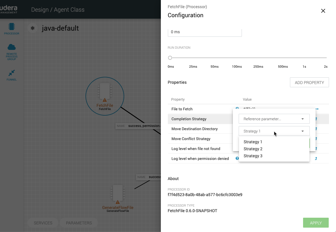

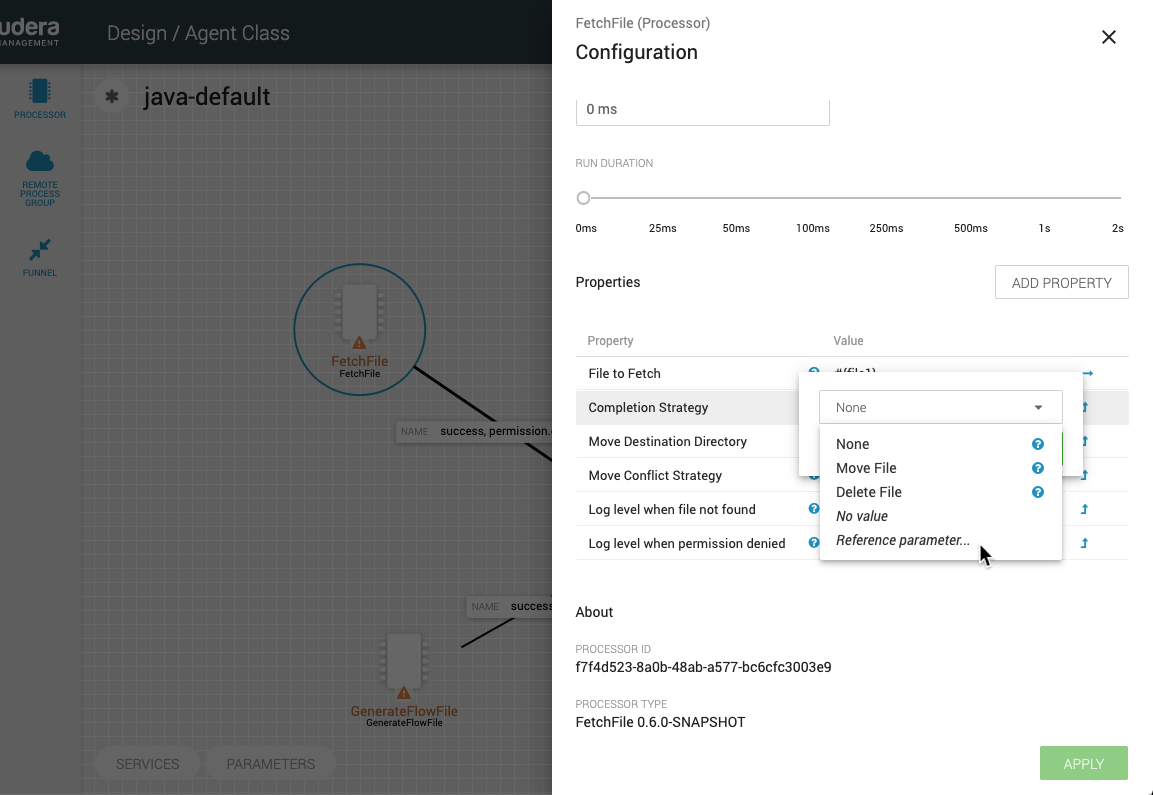

Property values that are selectable can also reference parameters.
  1. Select the property value drop-down. The option Reference parameter... is available for eligible properties.
  2. Select Reference parameter… option. A list of parameters to choose appears.
  3. Select a parameter and click OK.
