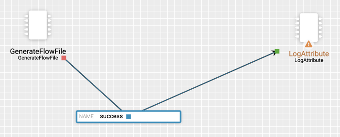

This section describes how to bend a connection.
  1. To add a bend point (or elbow) to an existing connection, simply double-click on the connection in the spot where you want the bend point to be.
  2. Use the mouse to grab the bend point and drag it so that the connection is bent in the desired way.
    The following image shows a bend point in the connection between GenerateFlowFile and LogAttribute processors:
    You can add as many bend points as you want. You can also use the mouse to drag and move the label on the connection to any existing bend point. To remove a bend point, simply double-click on it again.
