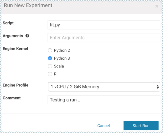

  1. Navigate to the Iris project's Overview > Experiments page.
  2. Click Run Experiment.
  3. Fill out the form as follows and click Start Run. Make sure you use the Python 3 kernel.
  4. The new experiment should now show up on the Experiments table. Click on the Run ID to go to the experiment's Overview page. The Build and Session tabs display realtime progress as the experiment builds and executes.
