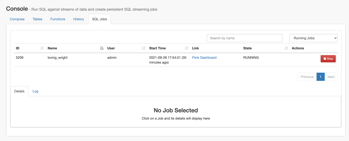

  1. Click Console on the main menu.
  2. Select SQL Jobs tab.
    By default, Running Jobs are displayed on the SQL Jobs page.
  3. Click on the job you want to stop.
    1. You can further filter down the results, by directly searching for the job name in the Search field.
  4. Click Stop under Actions.
  3. Click on the job you want to restart.

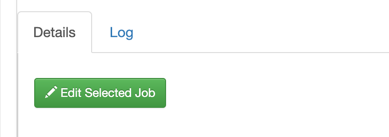

  4. Click Edit Selected Job under the Details tab.
    The SQL job and its configuration is loaded in the SQL window on the Compose page.

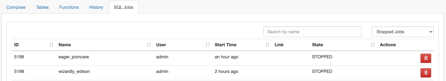

  3. Select Stopped Jobs from the drop-down menu.
  4. Click on the job you want to restart.

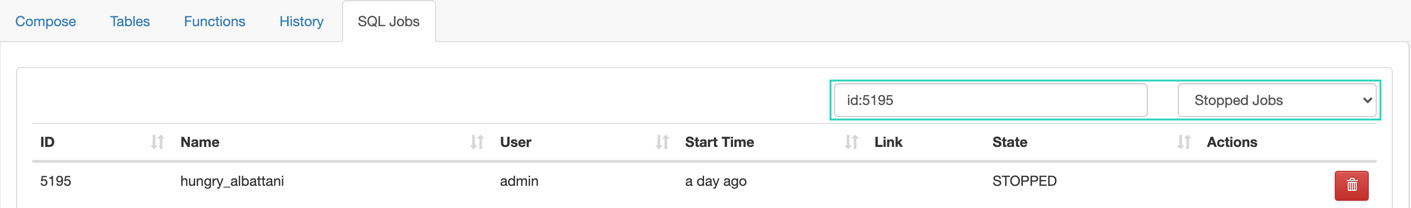

    1. You can further filter down the job list by searching for the job name, or locate a specific job ID by prefixing your search with id.
  5. Click Edit Selected Job under the Details tab.

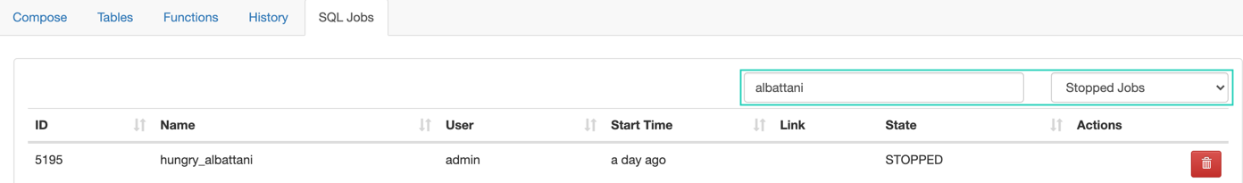

You can delete a stopped SQL job from SQL Stream Builder on the SQL Jobs tab. By deleting the SQL job, you remove them from the list of stopped jobs.
    The list of stopped jobs is diplayed on the SQL Jobs page.
  4. Click on Delete under Actions.
