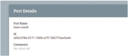

  3. Create an input port on NiFi.
  4. Capture the port ID.
    The port ID will be used in the Edge Flow Manager later on.

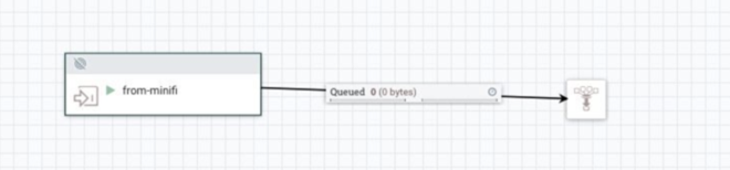

  8. To send data from MiNiFi to NiFi, add a Remote Process Group to the canvas and provide a NiFi endpoint.
  9. Connect the ConsumeWindowsEventLog processor to the Remote Process Group and provide the NiFi Input Port ID captured earlier.
  10. Click Publish.
    MiNiFi contacts the Edge Flow Manager at a set interval (nifi.c2.agent.heartbeat.period). Once that occurs, MiNiFi receives new run time flow instructions. At that time data starts flowing into NiFi.
