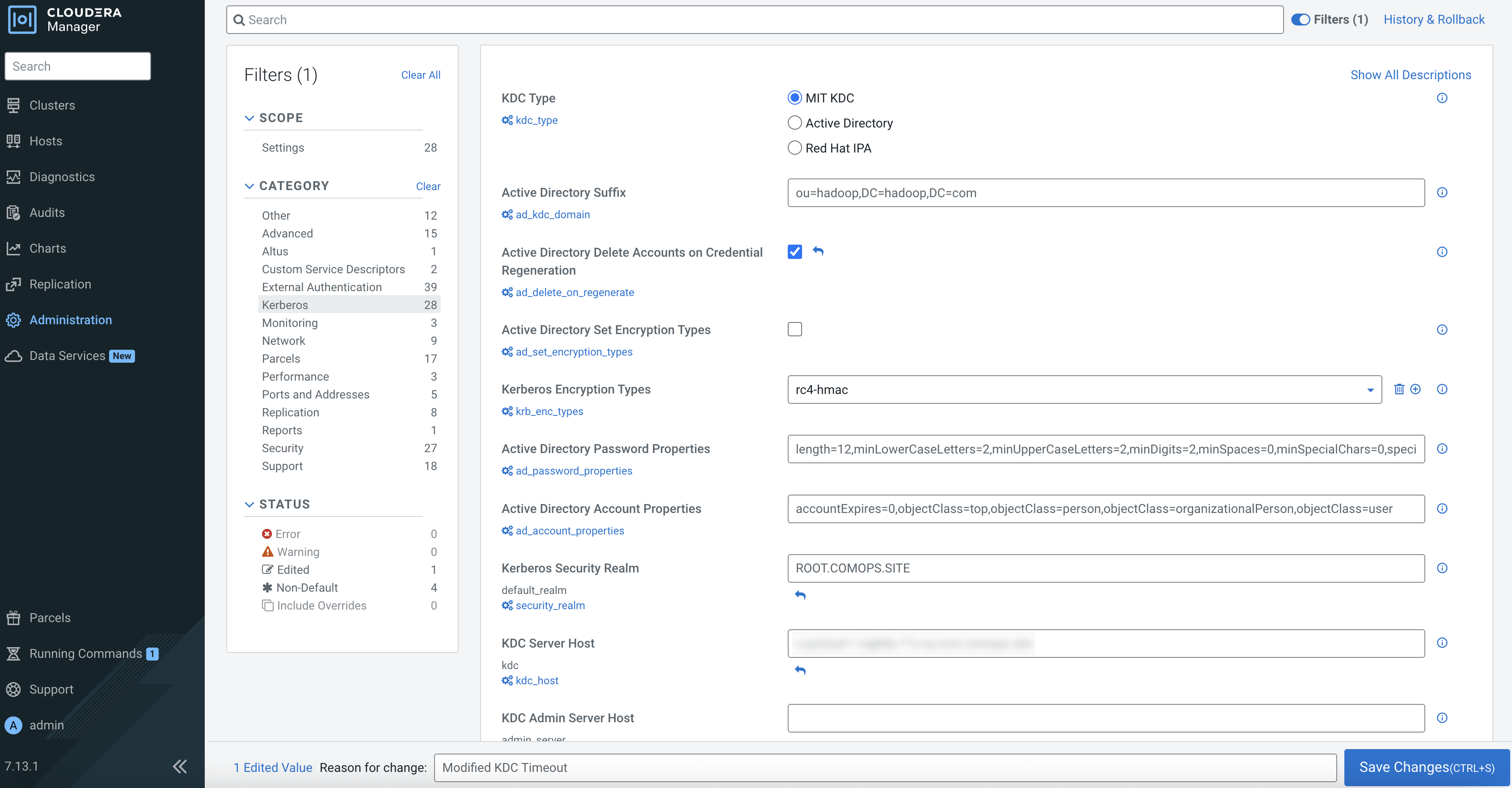

After Kerberos has been enabled on your cluster, you may need to update Kerberos configuration parameters. The required actions to ensure that the changes are applied correctly depend on whether Cloudera Manager manages the krb5.conf file through the Manage krb5.conf through Cloudera Manager option or if the file is managed externally.
  1. In Cloudera Manager, select Administration > Settings.
  2. Select Category > Kerberos to display Kerberos-related settings.
  3. Update the required Kerberos configuration parameters. Common parameters that may need updating include:
    • Kerberos Security Realm - The Kerberos realm name (in uppercase).
    • KDC Server Host - The hostname or FQDN of the KDC server.
    • KDC Admin Server Host - The hostname or FQDN of the KDC admin server.
    • Kerberos Ticket Lifetime - The duration for which Kerberos tickets are valid (for example, 10 hours instead of the default 1 day).
    • KDC Timeout - The timeout value for KDC communication (for example, 10 seconds).
    • Active Directory Suffix - The organizational unit path in Active Directory where service accounts are created.
    • Advanced Configuration Snippet (Safety Valve) for the Default Realm in krb5.conf - Used to configure additional KDC servers or admin servers. For detailed instructions on managing the krb5.conf file, see 3. Manage krb5.conf.
  4. If you want Cloudera Manager to manage krb5.conf across all hosts, ensure the Manage krb5.conf through Cloudera Manager option is enabled.
  5. Click the Save Changes(CTRL+S) button.
  6. If Cloudera Manager manages krb5.conf, stop the cluster by navigating to the Home > Status tab, clicking the three dots to the right of the cluster name, and selecting Stop. Then deploy the updated Kerberos configuration by selecting Actions > Deploy Kerberos Client Configuration, wait for completion, and finally select Start to bring the cluster back online.
    This action distributes the updated krb5.conf file and related Kerberos configuration to all hosts in the cluster.
